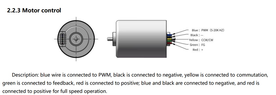

Hello,
I recently purchased a brushless peristaltic pump and have a question about it, which I'm hoping someone on this forum can answer. As you can see from the attached image, the pump has 5 wires. I've already figured out how to send a PWM signal and change the flow direction of the pump using an Arduino UNO, but the wire I am specifically enquiring about in this post is the green one, or the feedback signal. I am trying to control the peristaltic pump with a PID controller, and from what I understand, I need a measured process variable to help the controller determine how to minimize error, which I'm assuming the feedback signal can provide me with. 1.) How exactly would I go about reading/interpreting the signal from the green wire using an Arduino UNO? Is there a standard protocol to follow when attempting to read the feedback signal of a brushless motor? 2.) I'm aware that I need to know the pulses per revolution of the motor, which I already know, in order to calculate the RPM, but what equation should I be using after I've figured out how to interpret the feedback signal from the green wire?

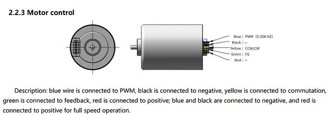

KPHM100 Product Manual A1.pdf (754.5 KB)
The specs of the motor is in section 2.2, but it does not state whether the feedback wire is a tachometer or encoder signal. I guess I could try both methods to determine what signal it is.
what if its a tachometer signal? or should I just use an interrupt with a timer regardless if its a tachometer or encoder signal
You should read and study the product manual of the pump refers to.

I found this in cache with google
so it would seem it's an encoder signal
