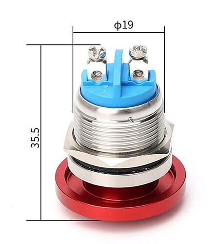

I am trying to wire up several momentary switches - but these only have two poles:
I have one pole going to the PIN5 (digital input) on the arduino, and the other going to the +5V line.
Where do I wire ground to with the 10K pulldown resistor? I was able to make this work with a tactile push button but that had 4 legs, so I am unsure what to do here. I am not an electrical engineer by any stretch of the imagination - so pardon my ignorance.
Thanks!

If using INPUT_PULLUP, then use this wiring configuration:
Terminal 1 to Pin 5
Terminal 2 to GND '
and use pinMode(5, INPUT_PULLUP); in the setup() function.
If not, use this wiring configuration:
Terminal 1 to Pin 5
10K pulldown resistor from Terminal 1 to GND
Terminal 2 to +5V
Reffer to @LarryD 's chart

barrychapman:
To the same pole as arduino PIN5.
In the picture your button has screw terminals so you can easily connect two wires to one pole
