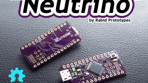

I bought a "Neutrino" board, and Arduino clone a few years back and it claims to be more powerful.
Decided to load the sketch on that board.
The sketch isn't compatible and will not even upload to the zero-clone. I get these errors:
