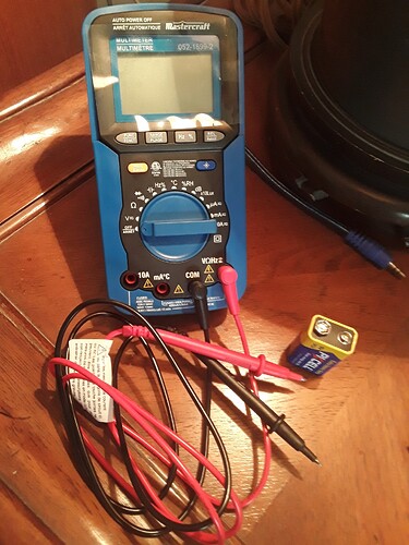

Hi I tried to use the mastercraft multimeter & connected the 9V battery & as result got reading of 0.015V on display of multimeter?
Than as you said take TV remote battery & check the same I got result of 0.018V on display? What is going on? Am i reading incorrectly from multimeter of this model?
I have attached image of Multimeter & searched Youtube for tutorials videos & I have found only 1 video worth while fit exactly for this model.
you have a great device! mine in mainly "hand operated".
According to the 0.018V value from the remote control battery, I expect your multimeter was on 2000V scale or so.
With a correct scale factor, you should read 1,8V. And so maybe 1,5V for your 9V battery.
EDIT: connection looks ok on the multimeter itself. Try changing the scale with the "range" button underneath the screen

I feel both 9V battery & TV remote battery are weak. Need replacing new ones.
Boy! is the remote control functionning? For what I read, you did good for measurment.
But both batteries look very empty!
Any chance you have unused battery to test? The other solution would be take a look at the user guide of the multimeter. At least, you learnt how to check a voltage by yourself!
