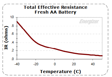

It easily produces 4.5 amps
Not at 1.5 V!
Do we need a remedial course in Ohm's Law? From the plot in reply #7, the internal voltage drop of a fresh AA alkaline cell providing 4.5A is about 0.25 Ohms* 4.5 A = 1.1 V, leaving about 0.4 V to power your device. And the internal resistance goes up with age and discharge.
Extending this to a fresh 4 x AA alkaline battery pack supplying 4.5A leaves you just 1.6 V to power your servos. That is not going to work!

jremington:
Not at 1.5 V!
And the IR goes down with temperature. Alkaline battery starts at around 1.63V (at least the 3 I just measured do). The IR you're quoting is notional and at 0 degrees. It's about half that at 20 degrees, a much more normal temperature to be working at.
So we started talking about 2A. 0.15 Ohm, 2A = 0.3V. 1.63V - 0.3V = 1.33V. 4 of those = 5.32V. No trouble running servos on that.
But I'd still prefer NiMH rechargeables. Lower initial voltage but hold up better under load. These days who uses primary cells for this sort of application?
The OP started talking about 4 servos.
For 4 servos moving at once, one should budget 4 Amperes, and not be so optimistic interpreting an idealized chart for a fresh cell.
Agree about the rechargeable cells, which have significantly lower internal resistance, but many beginners use alkaline battery packs and then wonder why their project doesn't work.
