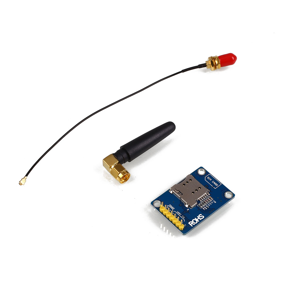

The GSM module (12€) I'm running is this:
Anyway, to be on the safe side and to run this for 1 month, if it was up to me I would just test the project with 1 battery, and then I would parallel 2 or 3 more batteries as needed. They cost less than 4€. Maybe upgrading to 18650 batteries would be a good idea, but watch out for fakes!
All my components were the cheapest I could find on eBay. An exception on 18650 batteries as there are a lot of fakes. Real and good ones are 2600mAh (max) and cost around 5€ (min).
