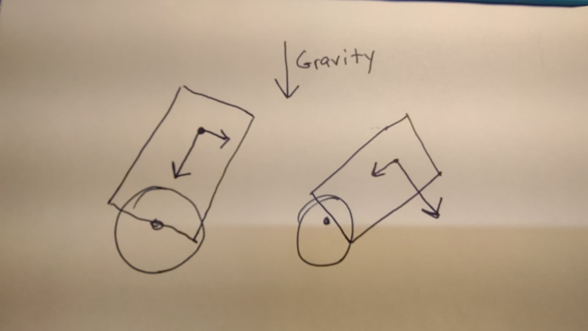

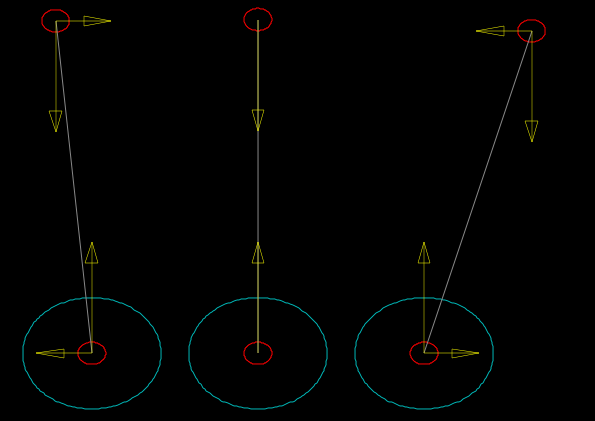

Try to draw the force balance that make the accelerations zero with this diagram:
If the combined center of mass isn't over the point of contact with the floor (tilt !=0), it needs torque to maintain the angle, which means the torque of the wheel has to be pushing the floor to the left, meaning the floor is pushing the cart to the right, and F=ma, accelerating the robot. You can't get zero acceleration (constant speed) at non-zero angles.
those 2 forces cancel each other out.

Those do not cancel -- one is the reaction force of the other. One acts on the ground, and its opposite force acts on the robot.

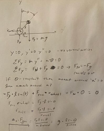

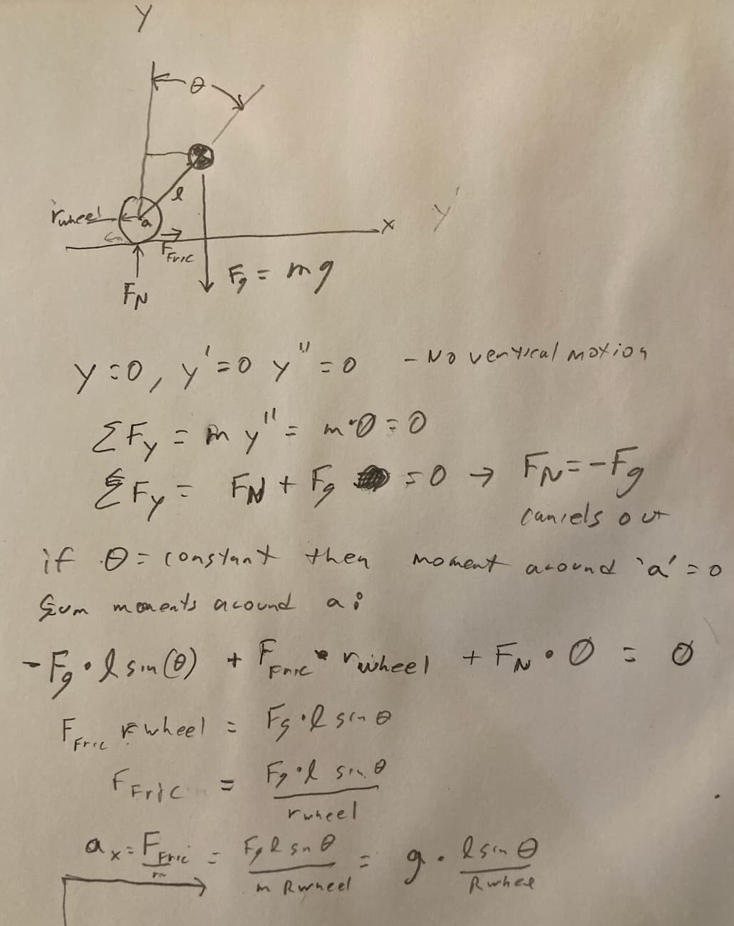

I think I was wrong here:
Since at angle a=45° you'd need to accelerate sideways at 9.8m/sec2 to balance the forces, and approaching 90° you'd need infinite acceleration. Both would quickly get you into the regime where air resistance would dominate.
It probably depends on the radius of the wheels and the height of the CoG above the axles, and some trig... maybe balancing torques around the axles:
-m g L sin(theta) = F_fric*R_wheel
F_fric = (m * g * L *sin(theta))/R_wheel
a_x = F_fric/m = g * L *sin(theta)/R_wheel
a_x = 9.81m/sec2 * sin(3°)*0.1m/0.05m = 1.02m/sec2
so with a 3° tilt, 10cm dia wheels, and 10cm CoG above axle, those speeds are about 1m/sec, 10m/sec, 1/100m/sec.
I doubt the steppers could deliver the torque at those RPMs.
