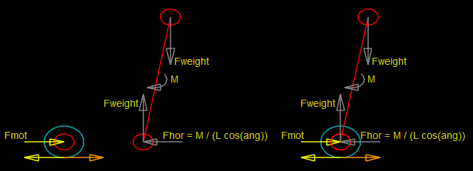

i don't know how the body can remain balanced over the wheel axle (angle == 0) and move forward. where's the horizontal force that accelerates the body sideways to match the speed of the wheel come from? perhaps you guys can describe (equations, diagram) how that happens
i still don't see a serious discussion of how the force of gravity on the leaning body can results in a horizontal force, Fx (that exists with an unpowered motor)
maybe this helps explains how the vertical force of gravity can result in a horizontal force
the body just sits on a wheel that the force of gravity due to the moment applies a force, Fhor to.
since the wheel is free to move/accelerate due to Fhor
fbd8 corrected
the vertical force of gravity due to the wheel+body opposed by the floor is not shown
That M force is real and present in our robot. If the wheels were unpowered and frictionless, you would see them go backwards due to that force.
In our world, the unpowered stepper motors are far from frictionless. They have a bunch of magnets in them that prevent frictionless movement.
if the moment can accelerate the wheel/body, can Fhor oppose a force due to the motor, Fmot such that there is no acceleration due Fmot ?

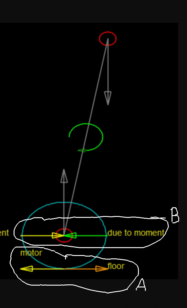

Take your diagram:
If the forces in A cancel, and also the forces in B cancel, then there's nothing else left opposing the moment, and the arm falls.
the green arrow labeled due to moment is opposed by the force of the motor thru the axle

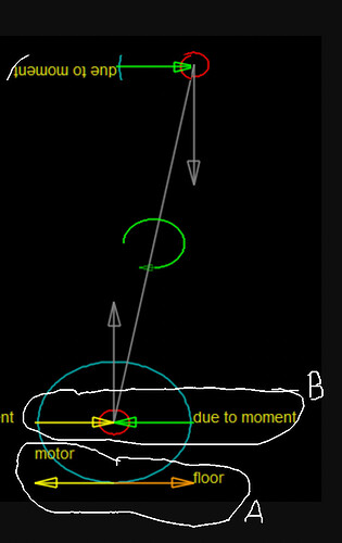

my diagram in post #137 tried to what the force, green arrow, is due to

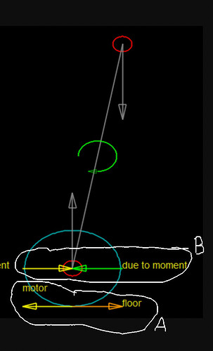

fbd9
the wheel on the left has no opposition and will accelerate
the center shows the body (without a wheel) and Fhor
the right shows the diagrams combined and that the fMot is opposed by Fhor
i believe the wheel/body won't accelerate because fMot is unopposed, that fMot == Fhor. that Fmot causes the wheel/body to move to the right, maintains it's speed. that because Fhor is opposed, the body remains at the same angle

The "green arrow due to moment" is part of a couple due to moment. If you place the bottom of a broom stick against a stop as you let it fall, and the force at the bottom of the broom is opposed by the stop, the top of the broom moves and accelerates to the right. Summing moments around the pivot point (and resolving them to a horizontal forces) produces an equal "force due to moment" working on the CoG:
If it were a ladder leaning statically against a wall, it would produce a "force due to moment" on leftwards the ground, and an equal and opposite "force due to moment" rightwards on the wall at the top.
If you take away the wall, and oppose the "force due to moment" with the inertia of the ladder, you again get F=ma.
yes. both the force on the floor and the wall are CCW and need to balance the the CW force of gravity
