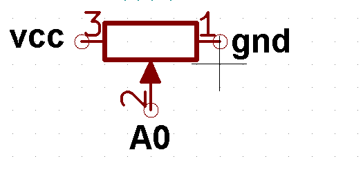

How should I wire a POTENTIO on KiCad and which should I buy?
Hi elentronic friends,
I have a questions regarding to KiCad in Wiring a Potentiometer:
How do I have to wire it ? My aim ist, to measer the position of the POT, in other words: whether it is set low, middle or high.
I have attached a Poti from CiKad Library... I simply do no know, where to connect the pins.. and I have no clue what the arrow means...
Pin1 to VCC ??
Pin2 to AnalogPin ?
Any PullUp or Pulldwon maybe ?

The last picture shows the proper connection. 3 to Vcc, 1 to Gnd, or the opposite!, and the wiper, 2, to an analog inout of the controller. No pullup nor any pulldown!
thanks, but are 10K POTs okay for a ATTINY24 ?
Yes! Perfect!
Thanks dude :smiley:

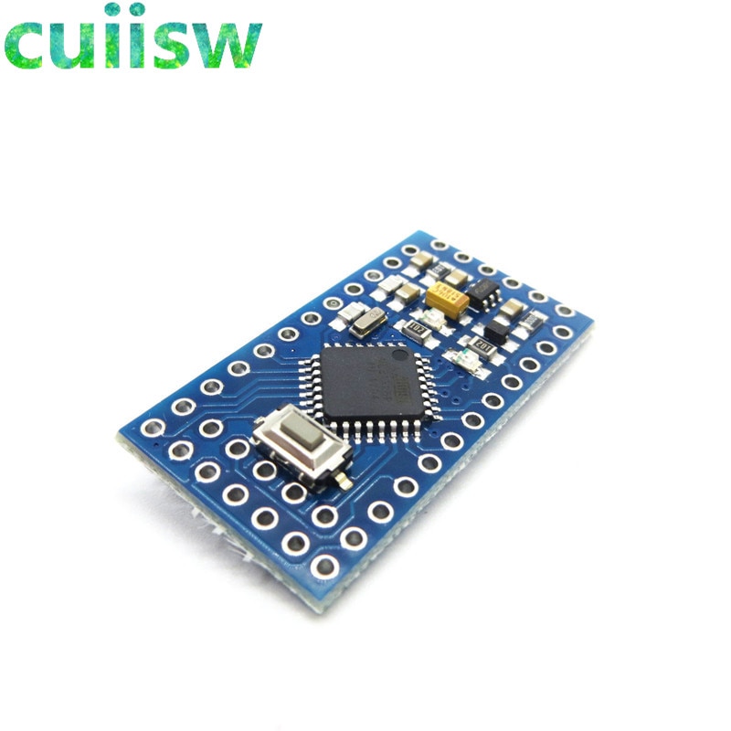

Most of us use the Chinese knock-offs which are (or used to be before the plague) inexpensive and in fact, hardly more than the ATtiny chip itself, certainly cheaper than assembling all the necessary parts.
A UNO is not at all suitable for most practical applications in any case; if you need USB connection then a Nano, otherwise a Pro Mini neatly contains on a board all the basic operational parts (and a couple of unnecessary ones - the regulator and the pilot LEDs though the pin 13 LED can be useful). :sunglasses:
