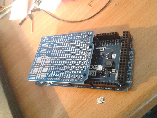

This seems to be a known problem, eg:
http://forum.arduino.cc/index.php?topic=197083.0
But I do not like the advice given in that thread (unsoldering the SPI connector).
I found a simple solution, just bend the three pins not available on shield (ICSP.1, .3 and .4) with a nipper to a degree of 45 degrees. That allows plug connection that stays below the proto shield:
I needed the SPI pins to connect a ILI9341 320x240 display. The border of the display does not allow to use a connector directly besides the display connector, therefore I made one connector a bit sloped with two little spacers:
3.3V was available once, but needed for LED and VCC of display. For that the 5x1 connector on the left side was added.
Finally I added two 3x8 connectors for a motor controller.
This is the connected and working result (Arduebot with ILI9341_due library "graphicstest" running):
The display on Arduebot will be used for PID controller constants determination while Arduebot is trying to drive fast parallel to a dentless long wall..
For me bending 3 pins seems to be less invasive than unsoldering the whole connector, and easier to revert.
Hermann.
The official Arduino Protoshield connects to the 3x2 SPI header.
So does the current Adafruit Protoshield.
It appears that you are using the old obsolete Adafruit Protoshield which does not mate.
Yes, I think it is an excellent idea to solder headers onto a Protoshield to suit your motors or ILI9341 display. You end up with a robust physical sandwich that has reliable electrical connections.
I really dislike the idea of bending the Due SPI header. It makes all proper shields inoperable.

afaik, all the Arduino AVR boards have connected the Atmega8 SPI (3x2) pins to D10, D11, D12, D13, GND and 5V and consequently, most (if not all) of the Arduino shields (including the official) connect also the SPI (3x2) pins to D10, D11, etc. Arduino Due doesn't use D10, D11, etc.. for SPI purposes and has its SPI pins connected directly to the SPI connector, thus, AVR and ARM Arduino boards don't match their SPI connectors. That's why we are forced to do the turnaround like HermannSW. Regards.

OK, this is the Uno Prot Shield I bought (photo below):
http://www.aliexpress.com/item/High-Quality-UNO-Proto-Shield-prototype-expansion-board-with-SYB-170-mini-breadboard-based-For-ARDUINO/32458717190.html
David was 5/6 correct, I just measured which connections exist for the 6 pins labeled ICSP on Uno shield at photo bottom corner:
ICSP.1 - D12 (MISO)
ICSP.2 - 5V
ICSP.3 - D13 (SCK)
ICSP.4 - D11 (MOSI)
ICSP.5 - Reset (not D10)
ICSP.6 - GND
As David said SPI pins are only available on SPI connector on Due, I was surprised when I encountered this as well:
http://forum.arduino.cc/index.php?topic=132130.0
I am happy with the solution (using Uno Proto Shield for Due), the female connectors are really firmly attached to the bended pins (which is really needed for Arduebot, fast moving autonomous robot). I do not plan to use any other shields and ordered 4 more shields yesterday, for 5$ in total with free shipping to Germany ...
Hermann.

Got new Due and new Uno proto shields and realized for the first time that Uno Proto shield has 3 holes exactly over SPI.1, SPI.3 and SPI.5 pins. SPI.2 (5V) and SPI.6 (GND) are not really needed because of 5V and GND rails on proto shield. Drilling a single hole for SPI.4 (MOSI) would avoid the need for bending.

Just from the postman, four 0.99$ Proto shields arrived, WITH Arduino Due SPI access!
I did put the pieces together (w/o soldering), and the 2x3 block for SPI access sits perfectly.
