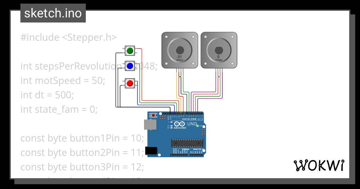

How to add start stop on my code
hello, I'm having trouble here, I only have 1 pin remaining (13) and I need to have a start stop button. Im thinking that the button that will be added can both start the code to run my switch case and when pushed again, it will pause the machine, and when pushed again, it will just resume its last case state, how it can be done?

The analog pins work as digital inputs and outputs.
const byte buttonStartStop = A1;
pinMode(buttonStartStop,INPUT_PULLUP);
if(digitalRead(buttonStartStop) ==LOW){...
and use the stateChangeDetection example code to set and reset a flag that you could use to inhibit other code.

look this over (untested)

thanks man, will look into it
its working, thank you

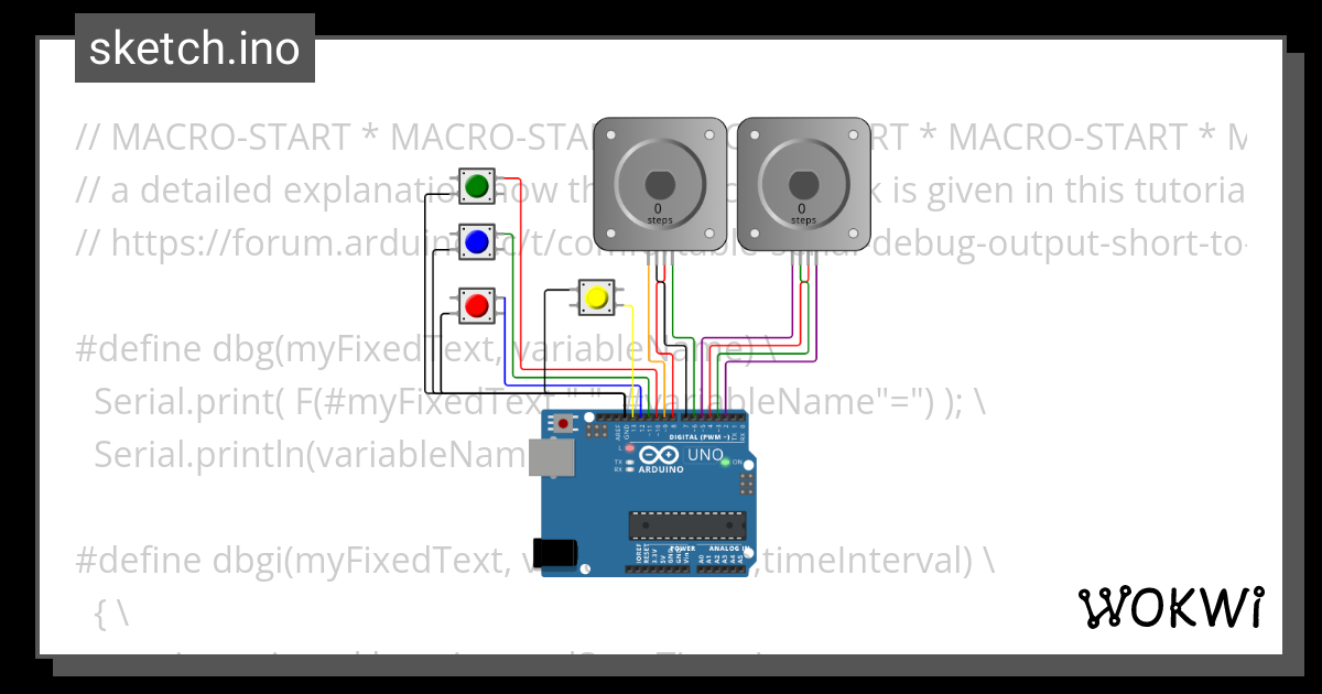

@shigs555
you did not explicitly write what microcontroller you are using.
From the IO-pins used it is very likely that you use an arduino uno.
As user @DaveX already mentioned you could use the pins A0, A1, A2, A3, A4, A5 as digital pins too.
So this would enable to have a separate start and a stop button and then there would be still 4 IO-pins left free for whatever you like.
You posted your sketch and a wokwi simulation.
Sure I can read the code I can watch the simulation.
Non-theless I highly prefer to know the backround of a code.
What is the purpose of your device?
Pretty often knowing the real thing enables to make new suggestions for solutions.
Sometimes much more elegant then the chosen one.
Anyway to explain what GCJR-code does
He defined the IO-pin 13 as INPUT_PULLUP
Then below your switch-case-break-statement he added the start-stop functionality.
Such a functionality works this way
You define a second variable "state_fam_old" to memorise the state your code was in in the moment of stopping.
This state can be
case 0:
case 1:
case 2:
case stop: (which is case "5"
This means if you press the button after stopping the code continues with the same state as before stopping.
Here is the re-modificated sketch as a WOKWI-Simulation

best regards Stefan

well the background of my device is a semi automatic presser
where initially stepper 2 will reverse to hit limitswitch 3
to stop stepper 2 and run stepper 1
now when stepper 1 hit limit switch 1
it will stop the stepper 1(which it holds now the limit switch 1) and run stepper 2 forward which also releases limit switch 3
if stepper 2 hit limit switch 2, stepper 2 will reverse
now my problem is that when stepper 2 hit limit switch 3, it immediately run my state 1 because my limit switch1 is being held.
how to fix it? im thinking i should cancel limit switch 1 when is was being pressed but I cant do it

can you post a picture ift his device.
Your explanation is still confusing me
Your code starts with
int state_fam = 0;
which does
    case 0:
        runStepper1 = true;
        myStepper1.step(motDir * 1);
how does this relate to
You should rename your states from 0,1,2,stopped
to meaningful names what the state is doing
The same applies to your buttons
Your description talks of limit-switches but your code talks of buttons
heres the image, its just a prototype for now thats why it is still in autocad
well i think debouncing limit switch 1 will do it
because I want to cancel limit switch 1 if it was pressed, tho Im not that familiar with writing debouncing
OK an image.
Where is stepper1 ?
where is stepper2 ?
again confusing
please write a description in normal words.
I want to emphasize: normal words
Normal words means: no coding terms just the words
  • stepper1
  • stepper2
  • limit-switch1 is attached to which stepper and gets hit when stepper rotates clockwise counter-clockwise ?
  • limit-switch2 is attached to which stepper and gets hit when stepper rotates clockwise counter-clockwise ??
  • limit-switch3 is attached to which stepper and gets hit when stepper rotates clockwise counter-clockwise ??
limit switch1 is attached to stepper 1 and gets hit when stepper 1 rotates clockwise
when limit switch 1 gets hit stepper1 will stop
and it will run stepper 2 clockwise
Limit switch 2 is attached to stepper 2 and gets hit when stepper 2 rotates clockwise
now stepper 2 will rotates counter clockwise and when it hits limit switch 3, stepper 1 should rotate clockwise
tho to pin point my problem
limit switch 3 should run stepper1 but it doesnt run
because stepper 1 is pressing limit switch 1
i need to run the stepper 1 while limit switch 1 pressed and be stopped when limit switch has been pressed again
it should be state 0 but it immediately goes to state 1 when the limit switches is like this
