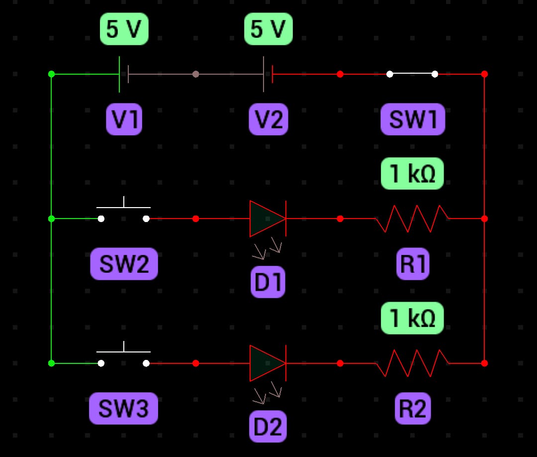

smh like this, although pasted 3 times over without extra cells
I would presume you want each button's LED to operate independent of the button-press. So (at a minimum), that would be an Arduino OUTPUT (for each LED) and an Arduino INPUT (to detect each button press).
As far as your schematic, I'm not able to clearly follow.
Also...those buttons don't look very "punchable" (in the sense that I doubt would be able to withstand a few good punches)...
That would be 4 buttons for 180 degrees. You are missing one button.
In post #6, if SW1 is not close, nothing will light... V1 is +, V2 is -.
Where is the Arduino?

Thats right... So i would need an arduino to control LEDs as outputs and button keystrokes as inputs.
So i reckon to seperately power the buttons and LEDs, although still connected to the arduino?
That would be 360 degrees.
270°

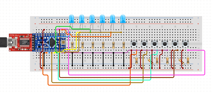

Just start with building a sketch to blink an independent LED. Then incorporate a button that you can detect it when it’s pressed. master those two activities first. Then you can start playing with a button that has a built in LED
smh like this maybe then
however is it possible to simplify this schematic?
