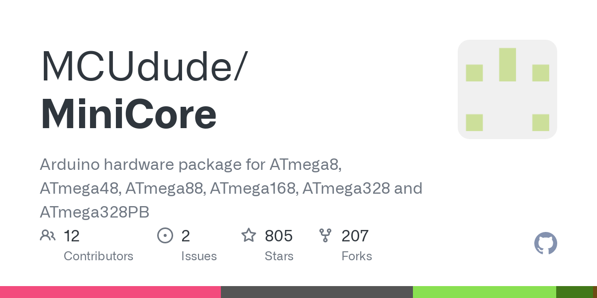

The easiest way to do it is by installing MiniCore:
After that you can select Tools > Board > ATmega328 and then Tools > Variant > 328 / 328A.
It says supported all varient " All variants (A, P, PA and PB)" but it doesnt have U
Thanks for your support it does support varient 328/328A
