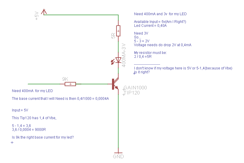

I was searching on internet in a while and found the Tip120 that I believe can handle easily 400mah. and is hfe 1000.
I made a simple design that I would like you to see if I'm understanding what you are telling me..
Could you take a look?
Bear in mind darlingtons don't saturate, since the collector is held at about 0.8 to 1.5V
above the emitter due to the configuration. So you'll probably get about 1/2 a watt of
heat from it. At least it has a metal tab for a heatsink.
2N2222 isn't going to handle 400mA continuous comfortably without a lot of current into
the base, perhaps 60mA, to bring the Vsat down. You could try driving it again with a
base resistor of 150 ohms, giving about 30mA base drive (the most that's safe for an
Arduino). 330 ohms is a bit too high. It will still run hot, its a small package.
Hi, Mark. What If i change and use a bd135 instead?
Look at its datasheet for the saturation characteristics? Is it better or worse?
