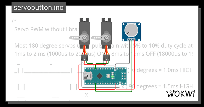

As @david_2018 wrote, standard servos use a common, adjustable pulse train. Here is a simulation using an adjustable pulse train to move a servo... the angle of the servo changes with the values created by the potentiometer. Real values are different from sim values.
