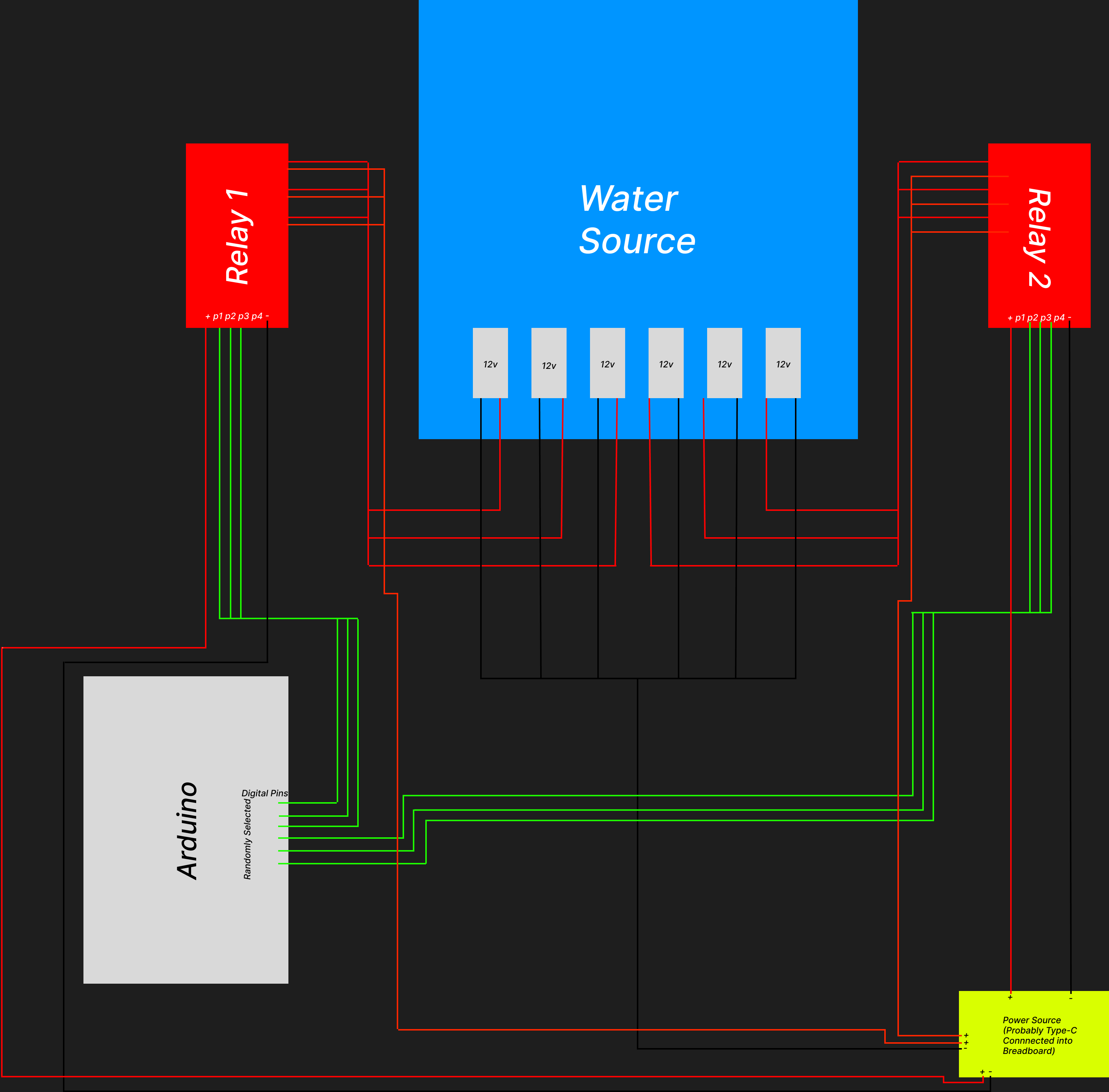

I have an Arduino R4 Wi-Fi for my projects, and i have 6 relay modules connected to 12v water pumps. When i was firstly trying to setup the project i just connected them all to Arduino's 5v output and...it failed. Right now i got 2 12v Duracell batteries and connected 3 of them to one of the batteries and 3 of them to other battery.

A drawing of how you wired and powered the arduino, the relays, the pumps and which type of relay you used would go a long way... Pumps are inductive loads, did you have a freewheel diode to protect the relay / arduino ?
umm, no.
probably the worst drawing you've ever seen.
i used this, idk which type is this.
we have seen way worse ! :slight_smile:
on the relay board you have a jumper on the right side
how did you configure that and do you understand what it's for?
you should unless the pumps are offering the protection.
You will need one 12V power supply and one 12V to 5V buck converter.
The 12V supply is for the pumps and the Arduino.
The 5V buck is for the relays.

they do have it.
each one needs 12v and they'll be used at the same time. 6x12 = 72 (i don't know how im supposed to calculate this.)
Do you have a datasheet for the pumps or a link to a website where you bought the pumps?
It should say: corrent is 2A or something like that.

Are you thinking of running the pumps for just a few seconds and then off for a minute? Do you keep the pumps submersed in water while they are running?
They won't last long on 12V and you will find they create a lot of noise that interferes with the Arduino but if you want to run them at 12V it's up to you.
However I highly recommend that you run them at 6V or less, most people use 5V with no problem.
More likely to run for 10 minutes and off for days
The reason why i give them 12V is, on higher voltages they pump more water. and for the project, the more water I can pump per second, is the better. There's might be a way to pump same water amount with 5v but i hasn't learned it yet.
like these ?
If you need more water flow, buy a bigger pump. If you supply 12V to a 6V pump it will not last long ...

so he is providing the expected voltage
Look at post #9:
He doesn't believe the datasheet and thinks he knows better.
