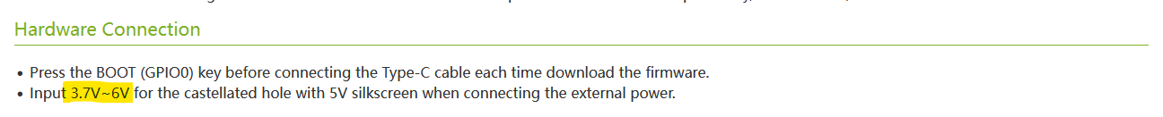

Jim, the first page in post #21 brings an interesting info:
If this is correct, 2x 3.7 Li-Ion is too much and 1x Li-Ion is enough. However, the battery should be connected at the 5V pin, not at the 3.3V one.

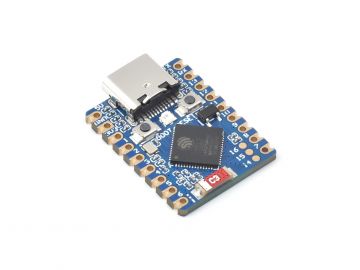

OP says he/she has a ESP8266 D1 mini and wants to do the same project with the ESP32-S3-Zero.
To the ESP32 situation, I would try what the page states and feed both the ESP32 (through 5V and GND pins) and the MPU6050 with one 18650 battery.

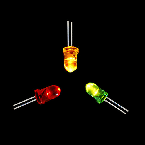

Which LED are we talking about?

https://shopee.tw/LED-3mm-5mm-LED3mm-LED5mm-η™½ε…‰-藍光-η΄…ε…‰-黃光-ηΆ ε…‰-ζ©™ε…‰-η™Όε…‰δΊŒζ₯΅ι«”-i.8182302.799045846?sp_atk=ee8ec007-85f8-47df-8501-6f4d16c5794b&xptdk=ee8ec007-85f8-47df-8501-6f4d16c5794b
like this one, i cant find the exact model for you but it looks like this and it is 3mm
I agree. that Esp32 has ME6217 voltage regulator, very low dropout at moderate currents.

if you mean the leds it is like this one
