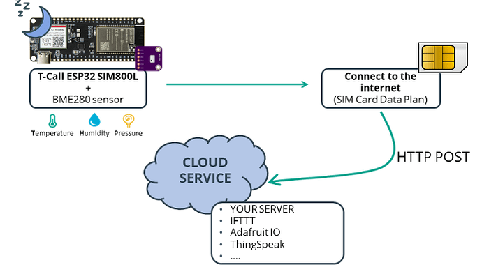

Only found limited info:
ESP32 SIM800L: Publish Data to Cloud without Wi-Fi | Random Nerd Tutorials
Seems like this doesn't show how to connect it to the Arduin IoT cloud though which is a shame but if I'm unable to I might use a different platform. Althought it seems like you should be able to since it can be selected as a device.
