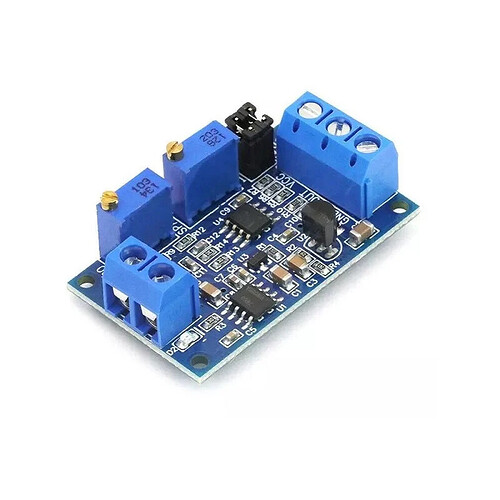

let me explain the project that I spoke about. I will be recieving 4-20 mah from different RTDs (temperature sensors). I am using 4-20 mah to 5 volt convertor module and sendingthe voltage to analog pins. Now if I use different pins then I will need many arduino mega boards. Can i use multiple input signals . If yes , Can anyone help me in telling me how this can be done. By qualfication I am into IT but arduinos for many projects. Thankl youin advance

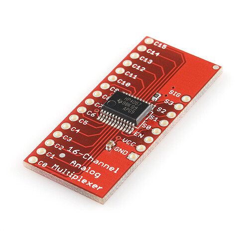

Analog multiplexers like the 4067 come to mind. 16 inputs to one output.
As @sterretje mentioned, there's the 4067. Sparkfun have a board ready to go for 6 USD:

4-20 inputs can be done with a sensing resistor, typically 250 ohms if feeding a 5V input adc. For your number of signals, I'd put a 4067 input mux(post #11) on each ADC input of your Mega until you get to your required number of signals. Then, in software, simply scan the N inputs, change the address of all 4067 simultaneously, and scan again. You may wish to do a bit of n-bit averaging to reduce input noise, but that's easily done. Ask if you want more details.
