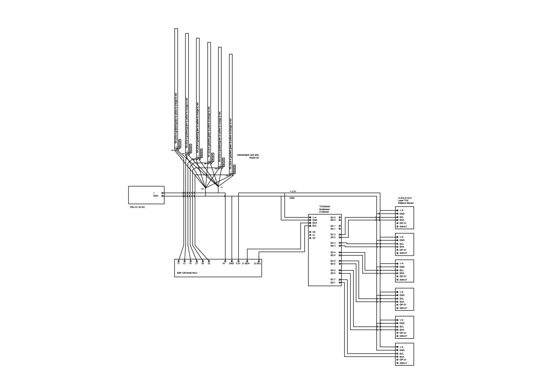

How to connect multiple multiplexer(CD74HC4067 16-Channel/PCA9548A 8-channel) to ESP32S NodeMCU to control 32 TOF sensors (VL53LDK)
I want to connect ESP32S to 32 sensors without using up as many pins. I did some research and I know I need some kind of multiplexer to handle this. I tried a few different multiplexers but I am not getting consistent results not all sensors are working together, some work some do not work, individually all sensors are working.
Also I am not sure if I should keep my ESP32S,Multiplexer,Sensors all on 3.3V or 5V.
My ESP32S is power via USB port on laptop and I have a 5V 5A PSU that can be used if required.
Eventually I want to scale this project to have 64 sensors that control 64 addressable LED strips (WS2812B) 5V. Control number of LEDs that light up based on distance.

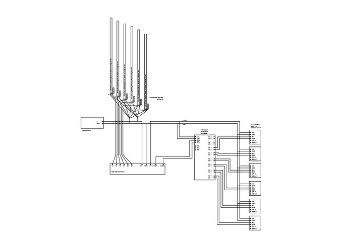

1 I2C Bus 1 16-Channel 4 Sensor.pdf (98.1 KB)
1 I2C Bus 2 8-Channel xshut 4 Sensor.pdf (99.9 KB)
2 I2C Bus 2 8-Channel 4 Sensor.pdf (96.1 KB)

Please check attached PDFs, I am trying all 3 approaches none is working for me !
I was thinking let me decide on the hardware part then I can post code for relevant circuit.
Can you please post your code and a schematic for each of your attampts.
If we don't know what you have tried, we cannot really help you.

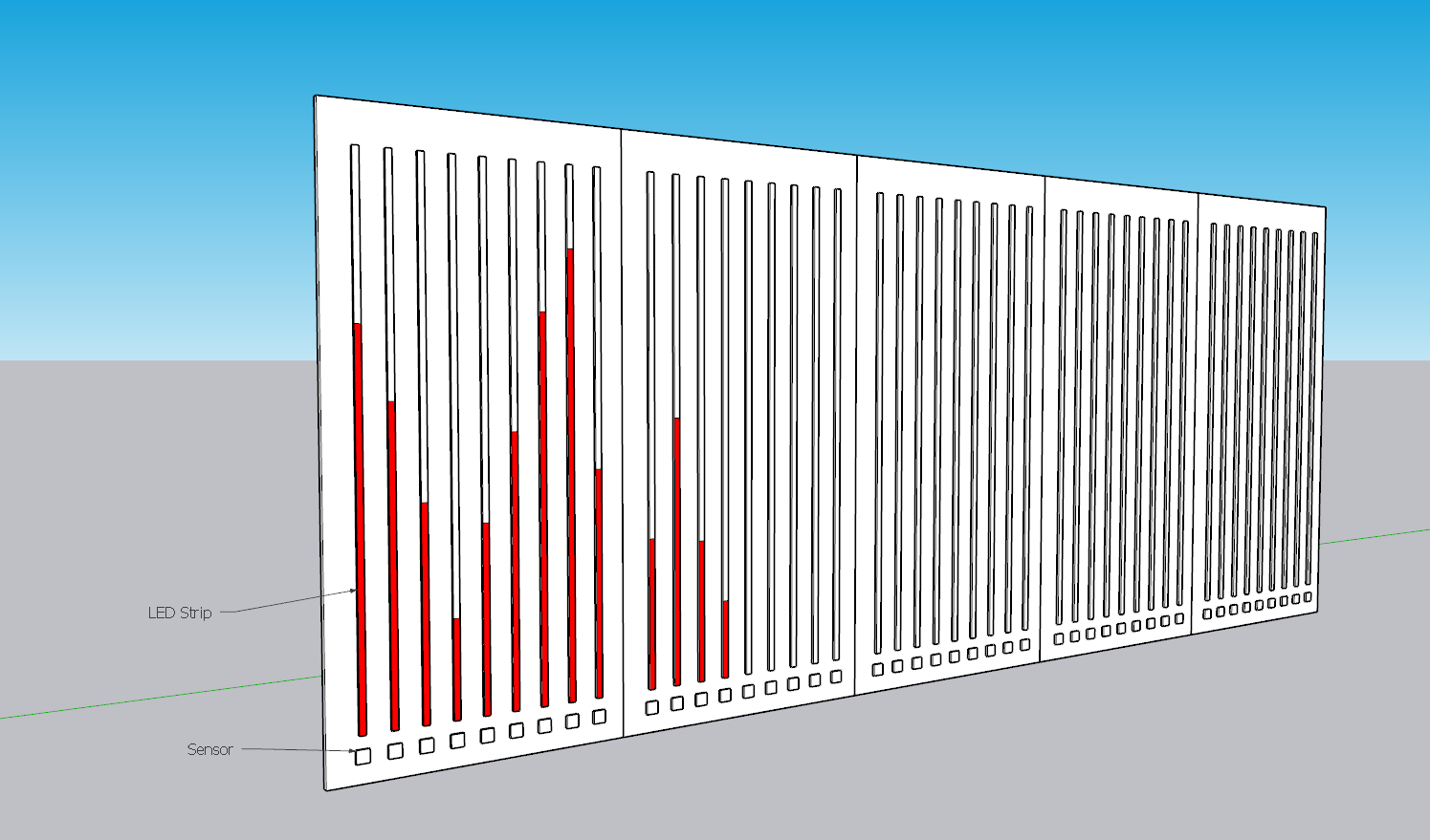

Interactive panel which lights up based on distance data from sensors.
Closer the person more Leds will light up, further the person less Leds will light up.
Aprox size of Panel
3.3Mts (10ft) length
1.2Mts (4ft) height
Space between sensors aprox 25-35mm

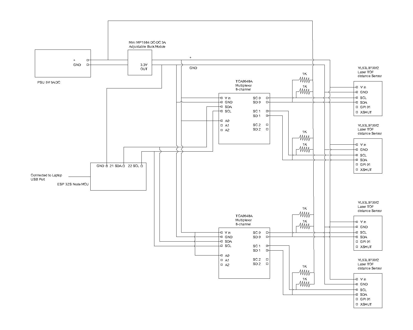

Since Esp32 has 3.3V operating voltage, correct supply voltage for multiplexer and sensors is 3.3V, not 5V.
If you connect one PCA9548A to pins 21/22 and few sensors to multiplexer, can you find them with TCA9548 I2CScanner sketch?
Ok, I will go with what @sterretje has suggested and go with 2 8-channel multiplexor also will update circuit as @kmin has suggested and get back to you after testing following this guide

1 I2C Bus 1 8-Channel 2 Sensor.pdf (97.1 KB)

This code correctly detects 2 MUX & 2 Sensors attached to each MUX correctly.
I have used TCA9548A MUX, used 3.3 V, pulled up SDA SCL lines to 5V.
Still sometimes it does not detect MUX, sometimes detects ghost devices, what can I do to make it more reliable. I pulled up using 1K resistors as I had only those available, and I doubt this might be the cause...
Next I will try to get readings from all these sensors, then add full 16 sensors and get readings from them. I am not sure exactly what resistor to use as pull up thought.
Last step will be to add LED strip.
I can't imagine the logic for that, except if you really want to damage something.
I was wondering the same but I read it somewhere...
I have updated circuit to pull up on 3.3V
Still occasionally ghost devices are detected what can I do to avoid this?
Your sensor module might already have pullups onboard (have a look) and even if they don't, I would go with 4.7k or 10k pullups. You could also try pullups on unused channels. And leave them disabled on your code.

I tried this setup
6 strips of 60 LEDs on WS2812b ( Powered by PSU 5V 5A)
6 VL53lox Laser ToF sensors via MUX TCA9548A ( powered by 3.3V of ESP32 )
ESP pins used for signaling 13, 12, 14, 27, 25, 32
This is working fine. All LEDs are lite up and as we move hand closer to sensor more LED turn off.

Now I want to expand this to 12 Strips which I was able to do successfully using 5V 5A PSU attached video
Video
The problem is when I replace a 5V 5A PSU with a 5V 20A PSU, all LEDS start blinking randomly and they are lit in random colors.
The reason I am replacing PSU is because I think 5A 5V PSU is stretched to limit when powering these 12 strips as some instability can be seen in 1 strip in video but that has settled down automatically now.
As far as I can say 20A supply will provide only as many amps as is demanded from it so 5A is able to handle it then 20A should be able to handle it comfortable. The funny thing is if I connect a different brand 5A 5V PSU even then the setup becomes unstable!
working 5A 5V PSU output voltage 5.5 to 5.7 5V/5A Maxicom Mini SMPS Metal Power Supply
not working 5A 5V output voltage 5.0 to 5.1
METEK-05V/05A-INDUSTRIAL DRIVER, 25W, Voltage: 24 V at best price in Mumbai
not working 20A 5V output voltage 4.8 to 4.9 5V 20A SMPS Power Supply at β‚Ή 350/piece | Switch Mode Power Supply in Jalandhar | ID: 2853915916388
Each LED strip is around 1.2 mts long
I would guess you are getting voltage drop on you LED strings. Measure the voltage at the LEDs and see what you get.
