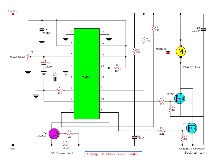

Ok, so I'm thinking ahead to when I get this all working. Once I have it all working, I will want a custom PCB. And to make it more cheaply, I'd much rather not be buying controller cards like discussed here. But designing my own motor controller from scratch is probably over my head. So can't I just use a design I find? If I google 24v motor controller, I get a lot of hits, such as this one:
What's wrong with that? Being new to this stuff, I'd think there was a standard source to find free (or to buy) circuit diagrams to solve common problems. Isn't there?

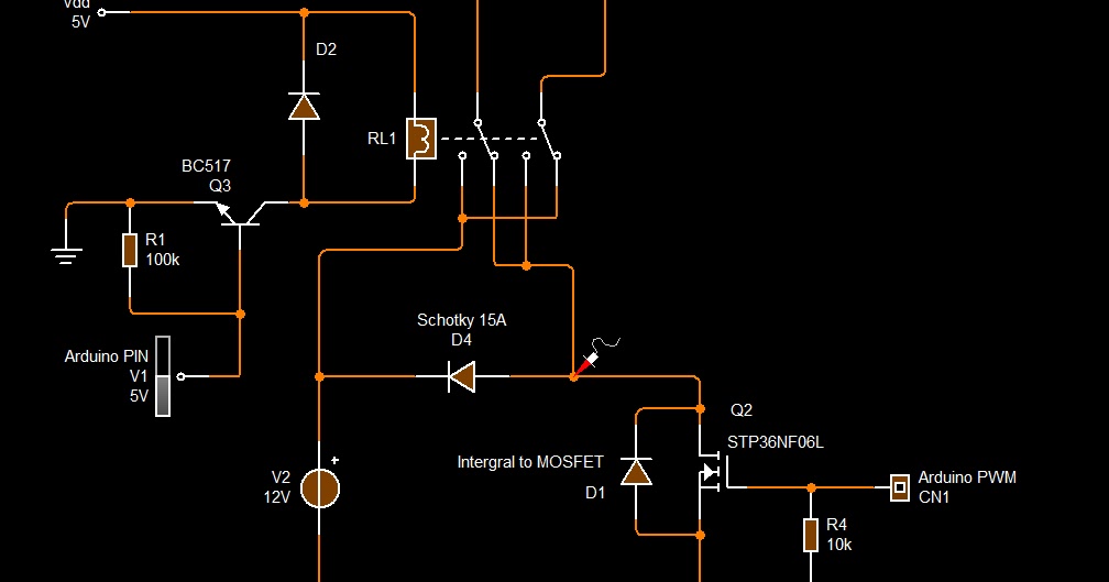

So if anyone knows of a simple motor controller that can handle 24 volts and just does analog input, let me know. I'd still rather not have to build my own. It seems like somebody should make one! Ideally it would only need to handle about 1.5 amps per motor, so I don't need big heat sinks. And I can give it 5 volts, so it doesn't need a voltage regulator either. Those nice little Pololu stepper motor controllers are more like what I have in mind. I wish they'd make a DC motor controller like that.
This link may help with what you are attempting.
Thanks! That looks like it could work, although it is designed for only about 2/3 of the power I need and still has huge heatsinks. Do you think they're necessary? The Pololu boards, even with the aforementioned issues for me, don't have heatsinks.
In any case, although I think I eventually will want to redesign this board with custom motor controllers, I'd still like to do rev 1 with off the shelf motor controllers, just simpler and smaller than the Pololu ones. Take the Pololu ones, remove the RC and serial interfaces, remove the software control, and the linear voltage regulators and I'd be all set.

Here is a useful datasheet for DPDT relay boards they do a 24v version:
http://www.audiowind.com/pdf/D-128.pdf
They have RC input
That makes things simple, you use the servo library to control them.
