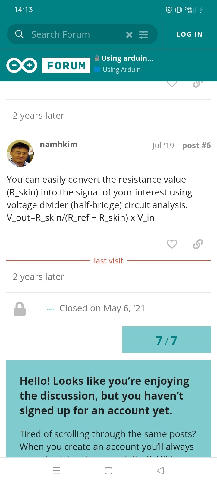

Thank you so much for the response john ,but this still dont answer what I am asking about how to convert the output or explaining the equation in my question
The equation provided by namhkim on that other topic is for a simple circuit comprising of a potential divider comprising of a reference resistor and the resistance of your finger.
The actual circuit of your sensor is much more complicated, and so that equation does not apply. (especially when there is a sensitivity control that can be set to any random/arbitrary position).

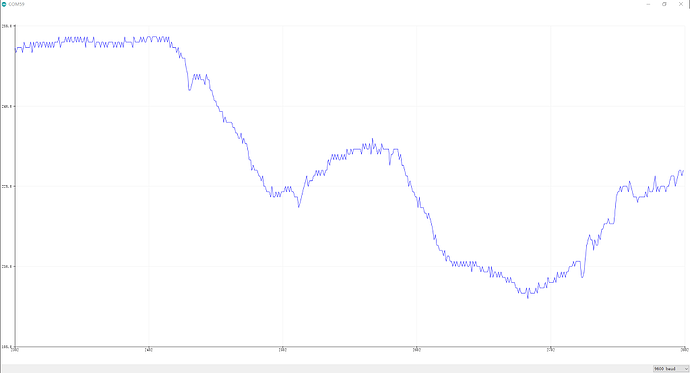

  • Step 5. Wear the GSR sensor.
  • Step 6. We will see the below graph. Please deep breath and see the trends.
Human Resistance = ((1024+2*Serial_Port_Reading)*10000)/(512-Serial_Port_Reading), unit is ohm, Serial_Port_Reading is the value display on Serial Port(between 0~1023)
After performing this procedure then I believe that the equation may be correct/valid.
So I've been using the new equation and turn out the output it's minus :rofl: , but if I do the calculation with the equation the output should be 100K+ by using 400 for gsr_average
Which is common skin resistance is 100k ohm , maybe I should adjust the potentiometer if It didn't work idk what else could work
