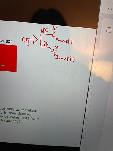

Here is a brief schematic of the circuit I was hoping to achieve. Mainly I am unsure of how to construct the HPF and LPF with only my small arduous uno.
Here might be a start.
Make a low and high pass filter.
Feed these to 2 transistor/opamp circuits then to two analog inputs on the Arduino.

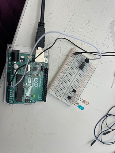

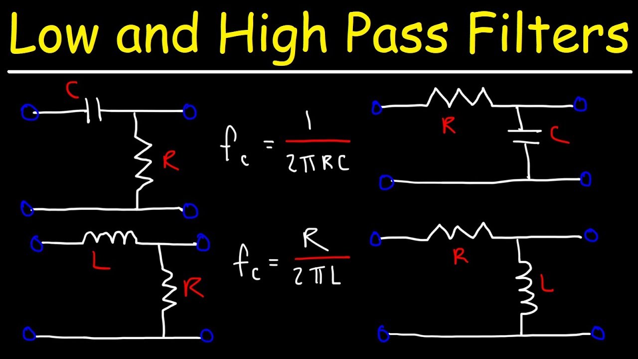

I have added the mic, op amp, transistors, resistors and LEDs. Not sure if they are in the right spots. I watched the video and know to use the RC for LPF and HPF. In the schematic it comes branching off of the op amp which I am unsure about.
Have a google of op amp circuits , you will need to amplify the signal from the microphone upto a suitable level for the Arduino analog input ; 5v.
Really it’s worth playing with some basic op amp circuits first with the aid of a cheap multi meter to get started .
Some basic circuit knowledge is useful
Example
And maybe
What video? What schematic?
The khan academy video suggested from a former comment
I guess my question now is can I put my HPF and LPF through the same op-amp or would I need to use two op-amps for each. Remember the goal is to have the frequencies of a song filter through and a higher frequency would lead to 1 LED to light while a lower frequency would lead for the other LED to light.
Two OpAmps.

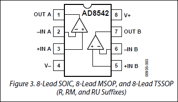

Do you have single supply op-amps ?
I am sorry I am unsure about this. The project is for school so I am not an expert with all this terminology. I have the analog parts kit from analog devices. https://digilent.com/shop/analog-parts-kit-by-analog-devices-companion-parts-kit-for-the-analog-discovery/
See your AD8542.
https://www.analog.com/media/en/technical-documentation/data-sheets/AD8541_8542_8544.pdf
