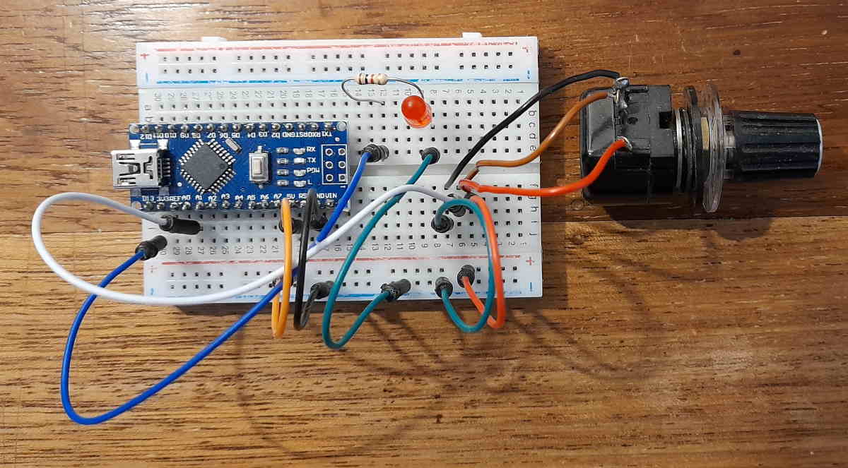

Lets get started making an image for a schematic you can post.
Fritzing (see below) or a photo of your layout aren’t really satisfactory, especially if it has more than a few components.
