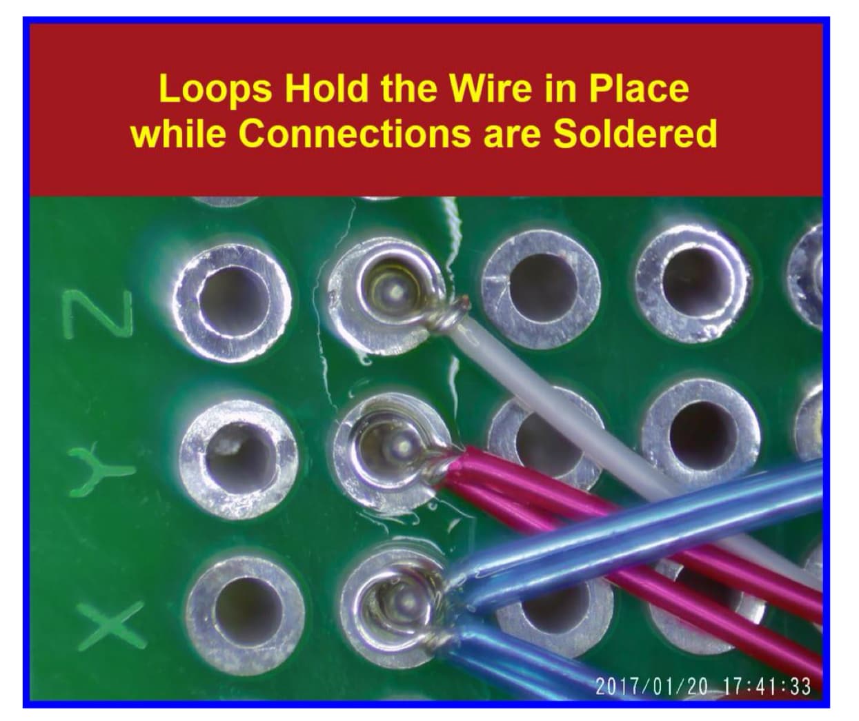

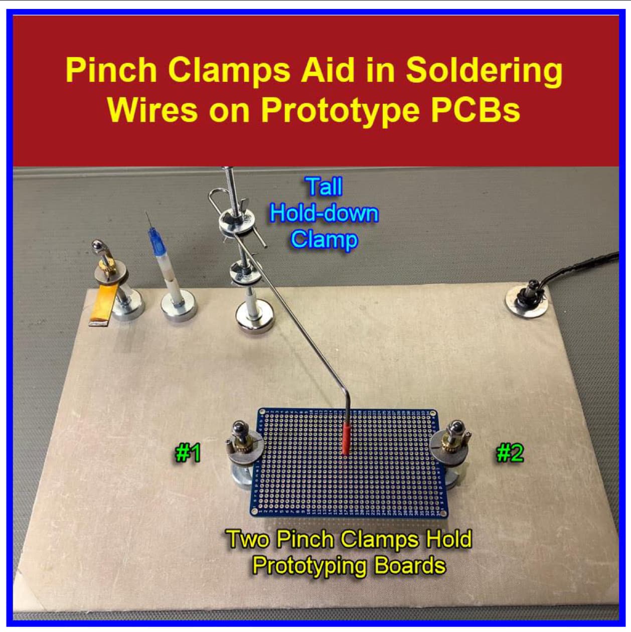

  • Both will work.
    My preference is perfboard.
  • This post might be of some interest:
