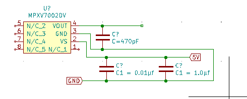

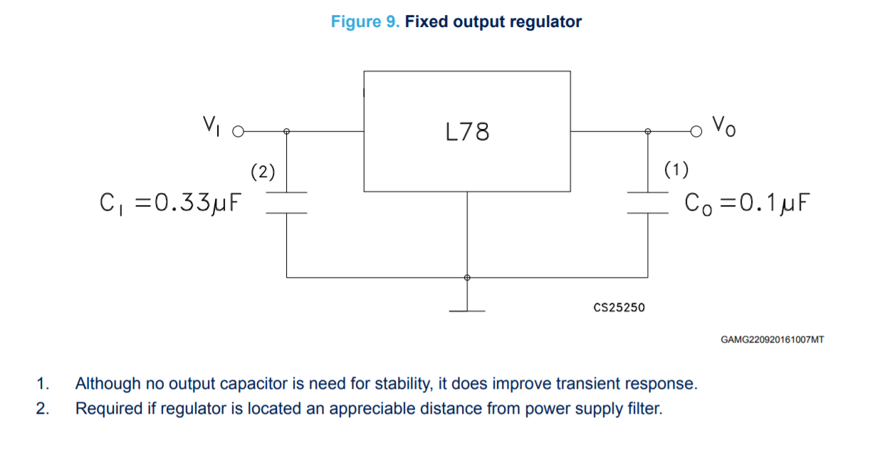

Thanks for your replies wolframore and slipstick. I have attached two small examples from a circuit I am trying to build. I have copied these from others on the net - so they may not be right.
The power source I am connecting is 12V 1A.
Thanks again for your help.
Gunnar

Both those examples are for filtering and they are critical. They are also the minimum values recommended from their datasheets. I haven’t used the pressure sensor but I know for certain the that regulator will not work without the caps.
The caps that’s are connected to power and ground are called bypass caps. They work by passing high frequency to ground while blocking DC (to ground). This cleans up some of the noise thats generated by the circuit. For instance that output filter cap for the 7805 helps to clean up the output, this filtering is necessary so that the 7805 won’t oscillate trying to regulate noise.
If you have an oscilloscope you can watch this noise. Take the cap out and see what happens.
The value calculation gets a little involved and again depends on the circuit and what noise you’re dealing with. Unless you like doing calculus use the recommendations. Experimentation can be done if you can see what’s happening.

I don't have an oscilloscope but AFAIK datasheets of those old regulators usually state the output cap is NOT needed for stability (in other words they will not oscillate); it "only" improve transient response. If you truly did this experiment can you post the pictures?

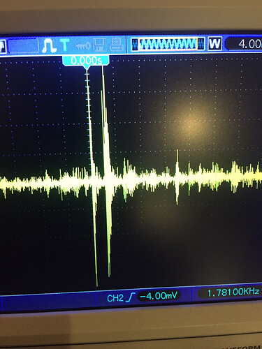

I found a 7808 - don't ask why I have those... no clue can't find any of my others. I mainly use SMD these days:
Here's the set up. Smajdalf is correct, regulation is fine without the output cap. I'm feeding then 12V. Keep in mind this is in a controlled environment so steady input voltage.
resulting noise... the division for chn 1 is is 10mV

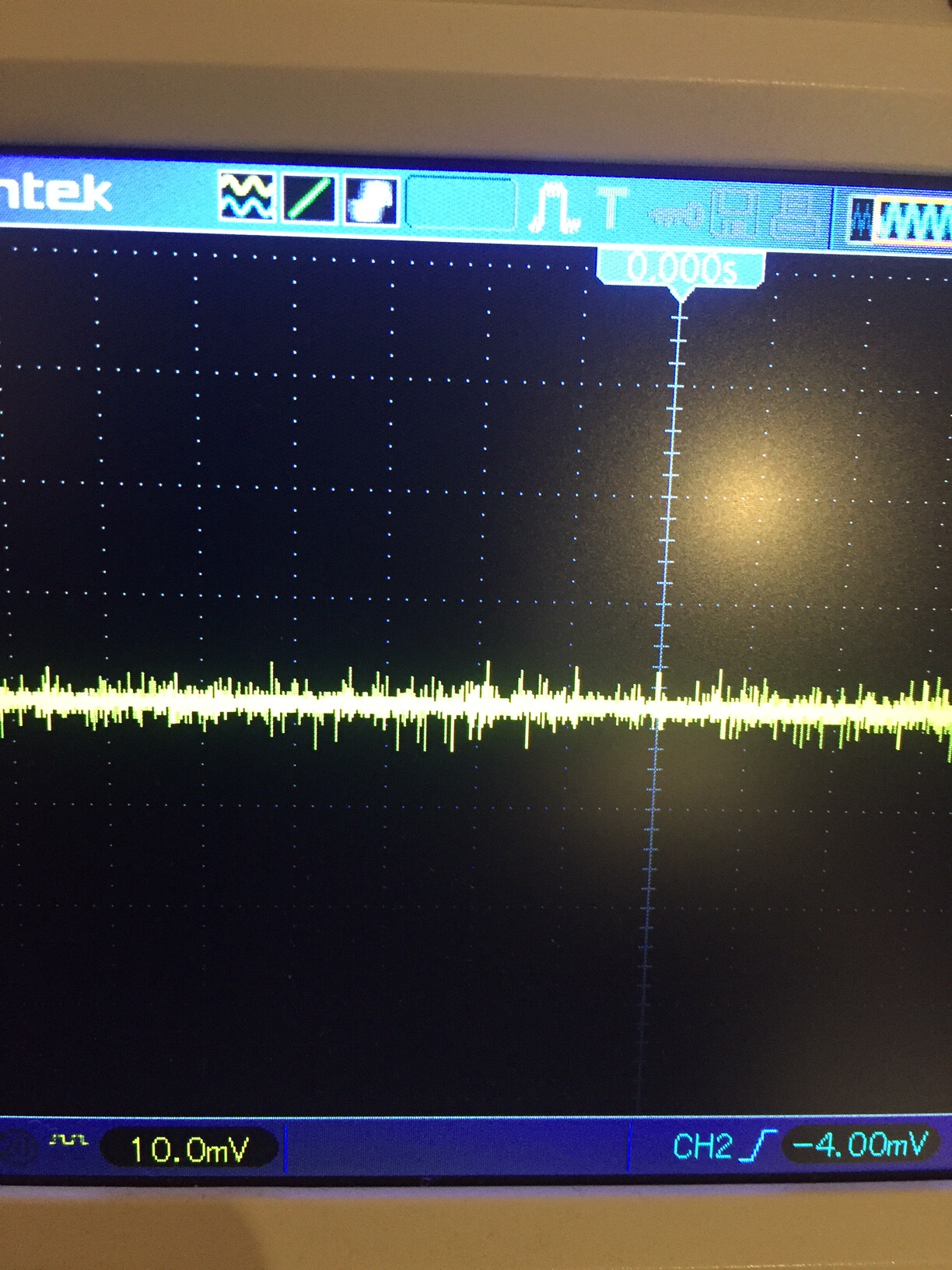

with a 0.1 uF tantalum on the output:
same 10mV division... look how quiet it is.
