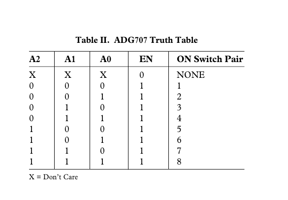

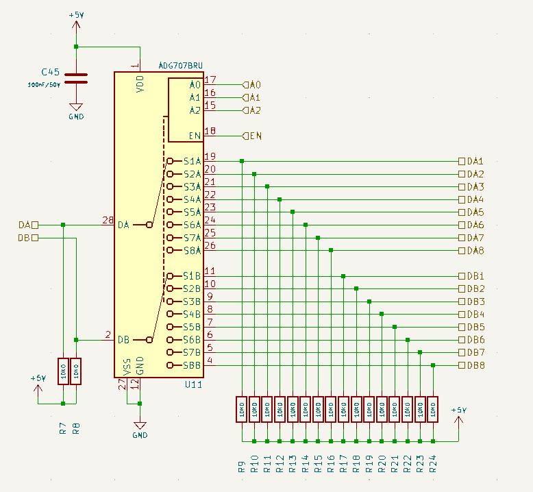

I have a pcb board that have the UART0 (its on the high densitiy connector, pins 49 and 50) to a multiplexer to read 8 different ultrasonic sensors
My issue is that the multiplexer seems to be not working, here is the code im testing and also the schematics of the circuit

The ultrasonic are UART controlled, so they need to receive a "1" to work, but my issue is that no matter the code or the serial i choose the rx and tx pins are always 5v (as they have pull up resistors) but i cant make this multiplexer work
Any help?

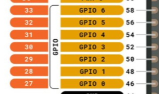

Use the Serial2 object in your sketch to communicate on these pins.
I determined that the Serial2 object is configured to use these pins by searching the core code:
If we wanted to find out which pins are Serial5, we can do the same, but in reverse:

However i still cant make this work so the sensor when i connect it to the da1 and db1 is still not communicating, the multiplexer truth table is this
In my code im doing this

im declarating the pins with those values following the schematics of the portenta c33

Pin 49 is the TX pin for Serial2 and pin 50 is the RX pin for Serial2. The fact that you are using for the opposite signals in your SoftwareSerial code indicates you might have the pins swapped for the purposes of use with Serial2 in your wiring between the Portenta C33 and the multiplexer.
Hi so i change that on purpose, but your message gave me an insight, it was no the pcb, it was a connection that was mixed in the US i corrected and now works fine

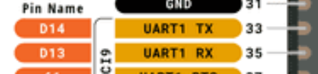

And about using the UART1 for the max232 (The first question on thus thread), im using the one that is on the high density connectors
Is this the same as the pin 14 and 13 of the portenta surface pins? or i have to declare it differently ?
It is the same. You don't need to do anything differently. Just use the Serial1 object in your code.
