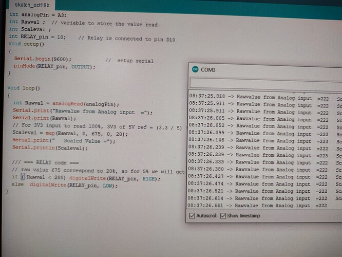

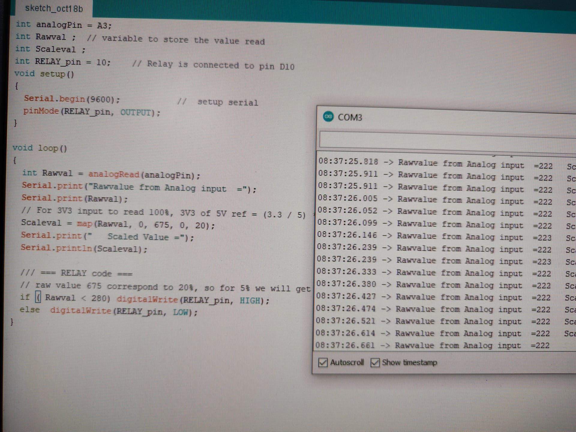

Without sensor connection -----how it is coming ?

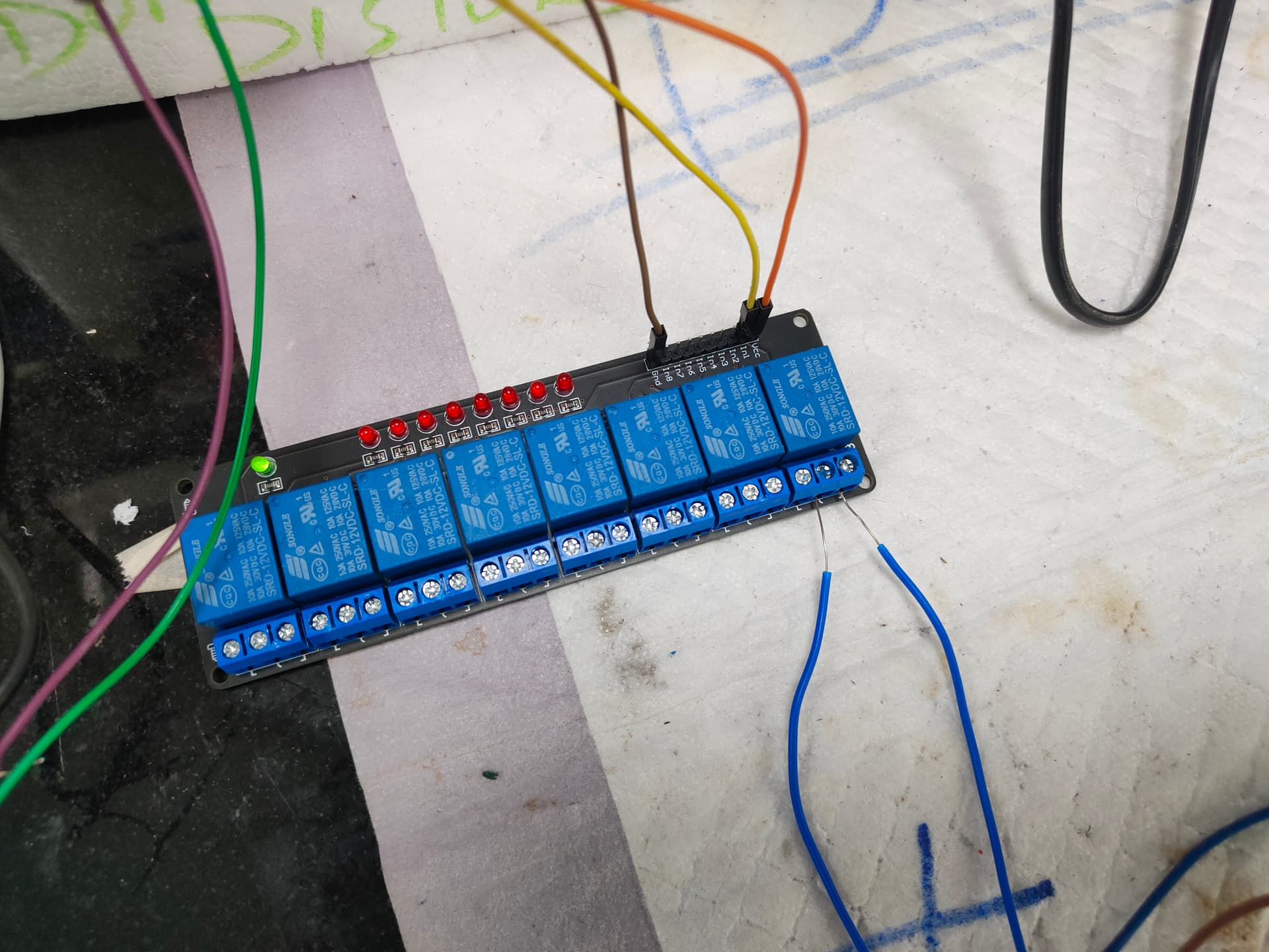

IMG-20221018-WA0032
Please
Yes, with the open floating input it looks about right. Running that code on an Arduino UNO if I apply 0.0 volts (ground) I get analog input = 0 and scaled value = 0. Apply 3.3 volts and I get analog input = 687 and scaled value = 20 just as expected.
Next to get this on your display the make and model of the display need to be known. There are many TFT displays and associated libraries.
Ron

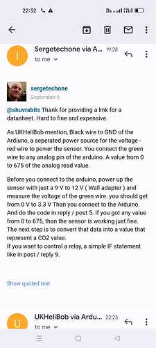

I need 2 things to know -
1)OLED display of sensor data
2) How to measure voltage from multimeter& associated logic % for co2

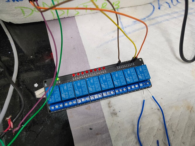

Relay pin is not operational
Can you please tell us your electronics, programming, arduino, hardware experience?
Sorry, but we need to know your level of knowledge?
Is this a school/college/university project?
Did you write this code or is it from another source?
Where as it is working for
What is +ve & -ve?
What is the lead from, is it AC or DC?
Tom... :smiley: :+1: :coffee: :coffee: :australia:
