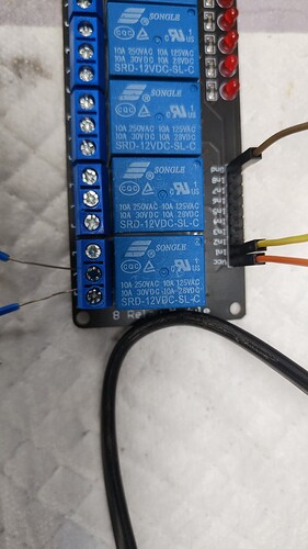

Relay pin is not operational

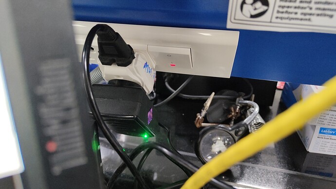

Seller told me that it is work fine with AC supply .Please suggest for relay operations
Please
Whereas It is working properly for
What is +ve & -ve?
Looks like a 110V/220V cable; what is the other side?
Disconnect the relay module, run the program and check the output level with a multimeter.

Other side is Plug & another sode is solenoid valve for pressure regulator for gas.
How to to check with multimeter ? I am using 12 V DC relay .

Measure voltage. Connect one probe to GND and the other one to the output pin. Let your program run so it activates the relay and observe the different measurements (with and without relay active).

int analogPin = A3;
int Rawval ;  // variable to store the value read
int Scaleval ;
int RELAY_pin = 10;    // Relay is connected to pin D10
  Serial.begin(9600);           //  setup serial
  pinMode(RELAY_pin, OUTPUT);
  int Rawval = analogRead(analogPin);
  Serial.print("Rawvalue from Analog input  =");
  Serial.print(Rawval);
  // For 3V3 input to read 100%, 3V3 of 5V ref = (3.3 / 5) * 1023 = 675
  Scaleval = map(Rawval, 0, 675, 0, 20);
  Serial.print("   Scaled Value =");
  Serial.println(Scaleval);
  /// === RELAY code ===
  // raw value 675 correspond to 20%, so for 5% we will get 169
  if ( Rawval < 169) digitalWrite(RELAY_pin, HIGH);
  else  digitalWrite(RELAY_pin, LOW);

Seller (solenoid valve)told that it is functioning when it will get AC

Your relays are 12V coils, what are you powering the assembly with?
