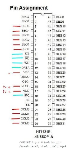

Ok... a quite high level view on this.
You have a book.
Each page of the book has 4 boxes labeled COM0 to COM3.
Since you only connected SEG0 to SEG5 you only need 6 pages (page 0 - 5)
With void sendData(uint8_t address, uint8_t value) you can write to the book.
address is the page number and value ticks the boxes.
The value 1 ticks the box COM0.
The value 2 ticks the box COM1.
The value 4 ticks the box COM2.
The value 8 ticks the box COM3.
You can sum up stuff. 5 ticks COM0 and COM2.
Now the controller reads through the pages.
For Page x it copys the boxes to the output COM0 to COM3 and it activates SEGx.
Now your LCD is wired as a matrix. Each segment is connected to one COMx and one SEGx.
When both output high, the segment turns on.
Depending on your wiring, this might light up every segment one after another on one digit:

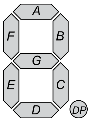

I think now is the time to create a lookup table for number -> segment pattern.
What do you need to call to light up segment A (B,C,...,G)?

My LCD does not have that DP point. Only 7seg digits x3
Here is the Segment order:

Here is how it goes.
  1. Print out the image of the seven segment above
  2. Fill out all segments that need to turn on for the number 3
  3. Write the segment names down
  4. Go to LutEven index 3
  5. Replace the uppercase names with
  • 1 when the segment needs to be on
  • 0 when the segment needs to be off
    using this template: 0b0CBA
  1. Similar for LutOdd with this template: 0bDEGF

So now to display a 3 we need to turn the segments ABCDG on
From previous experiments we know how to turn on single segments.
This should give us a flickering 3:
while(1)
      sendData(adr[0],seg[1]); delay(t);    //a
      sendData(adr[0],seg[2]); delay(t);    //b
      sendData(adr[0],seg[3]); delay(t);    //c
      sendData(adr[1],seg[2]); delay(t);    //g
      sendData(adr[1],seg[4]); delay(t);    //d
