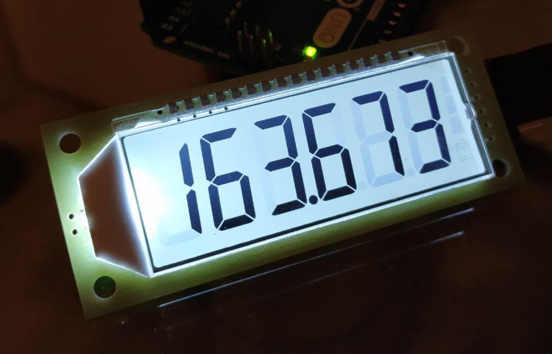

Hi, I have a working library for HT1621.
Here is the code that is counting correctly and efficiently some numbers.
This is actually one of the example codes that comes with this library.
This program is made to drive a HT1621B LCD Driver IC
HT1621B only multiplexed LCD Driver  1/2 or 1/3 bias, and 1/2 or 1/3 or 1/4 duty  SSOP48 [smd]
#include <HT1621.h> // include our library
HT1621 lcd; // create an "lcd" object
  // cs to pin 5
  // wr to pin 3
  // Data to pin 2
  lcd.begin(5, 3, 2); // (cs, wr, Data)
  lcd.clear(); // clear the screen
  lcd.print(millis()/100000.0); // print the floating point seconds value with 3 decimal digits precision
  delay(1); // wait 1 millisecond
All I want is to be able to drive individual digits AND individual segments.
Is it possible with this library? Or do you recommend another library than this?

I find how to set up individual digits. And it is a very straight forward in doing it !
lcd.print(1,0); //will print num 1 on the LCD
lcd.print(11,0); //will print num 11 on the LCD
lcd.print(111,0); //will print num 111 on the LCD
But individual segments? Hmmm...
I was thinking to modify the original class, and add myself a 'segment' function, but Im afraid not to mess up something . - Can we modify it?

I find this
char HT1621::charToSegBits(char character) function inside cpp file and I made it public (it was private) and I can access it from my main code.
-But, Im getting some errors if Im using it like this: charToSegBits('|');
LCDA2:20:3: error: 'charToSegBits' was not declared in this scope
-Then I look more closely how is used in the cpp file and is always used like this:
_buffer[i] |= charToSegBits(character); in only 2 print() functions. This means... it is OR-ed and compared to an array? I don't understand it.
I discovered this function void HT1621::print(const char* str, bool leftPadded)
And, I figure out how to write to it!
you write like this: lcd.print('-',false);
but is one problem... it is converting into ASCII Decimal
for ex:
if Im writing lcd.print('-',false); I get 45 displayed on my LCD
if Im writing lcd.print('a',false); I get 97 displayed on my LCD
if Im writing lcd.print('|',false); I get 124 displayed on my LCD
So, I quickly looked into an ASCII table and it is exactly this conversion.
Hmmm...

No. The function you discovered is expecting a 'C-string' which is a null-terminated array of char. You gave it a single char.
So the function you discovered will not be used. Instead, the other function you used before is being used again:
The single char you gave as the parameter is getting converted to its ASCII code and that code is getting printed.
Try this:
lcd.print("-",false);
Using the double-quote symbol instead of the single-quote symbol makes it a C-string instead of a single character. Now, the function you discovered will be used.
I try it and nothing appears on the LCD.
At least with my approach it is showing something.
Or, this is a very special or dedicated function for a very special LCD that I dont have.
Maybe, yes. It was worth trying, and now you understand that single-quote and double-quote have different effects/purposes in C.
this is a subject related to "string manipulation" which is one of the basics of C languages, and which I am very good at in C# at least - not so much here in C++ arduino because it involves (probably) pointers and more low level than c#. I do know about these differences, but here in this case, I didn't perfectly understood what that function really do inside it. So I play with it until I got a result. Thanks for your input.
