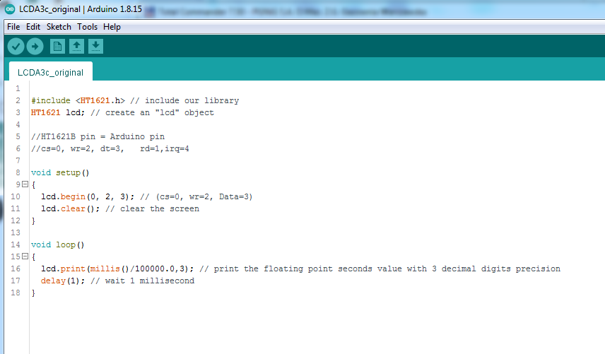

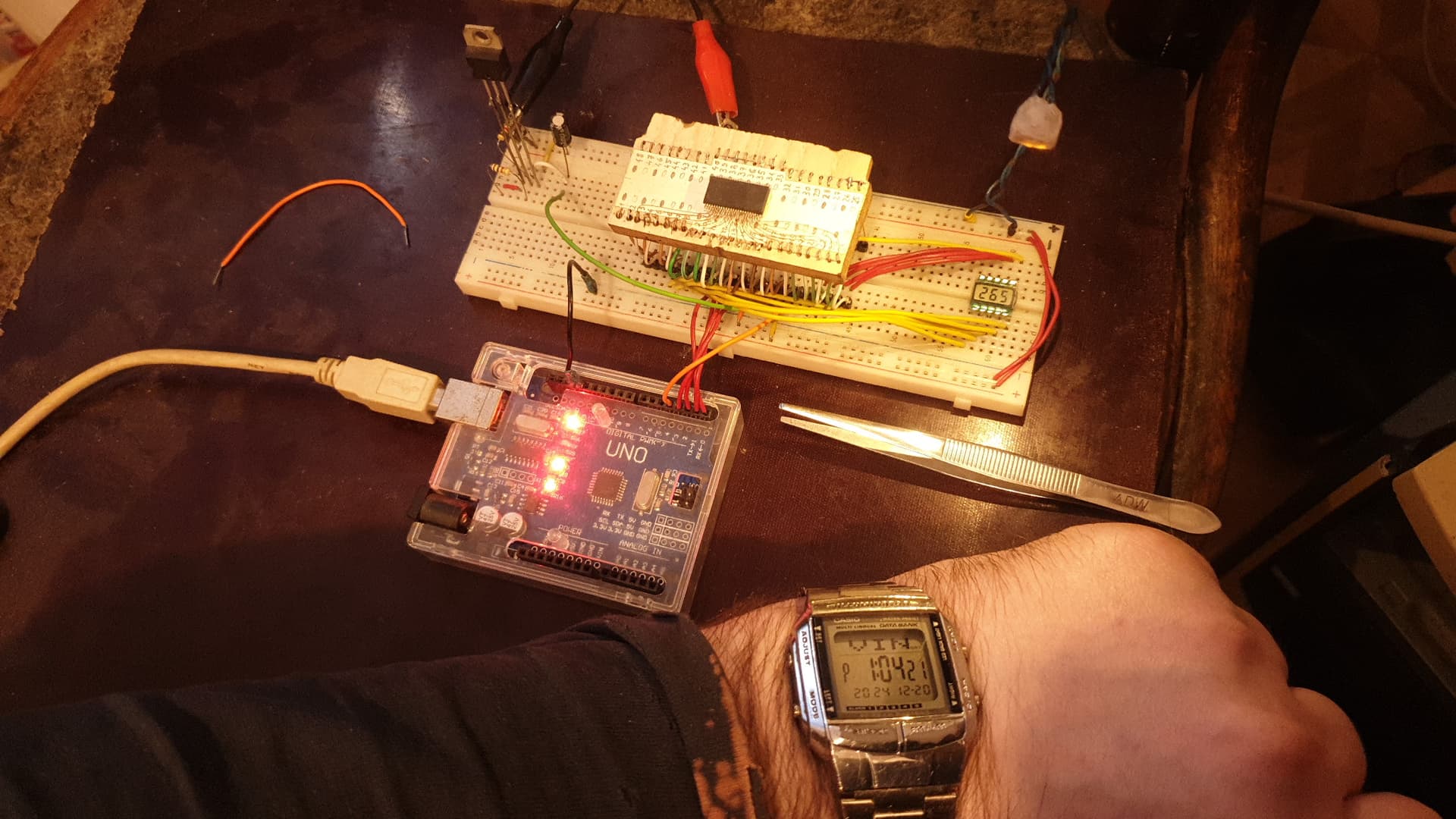

Im bitbanging using arduino uno R3 board, with direct wire links to the IC pins.
So this is a working setup, that is using
lcd.begin(0, 2, 3); // (cs=0, wr=2, Data=3)
where, cs=0 means that IC cs pin is linked to pin0 on arduino. , The same logic applies for the other pins in the arduino code + library.
Im using a test program to reassure everything is connected and working correctly.
Next is to actually find a way to bitbang this IC input pins. Those 3 mentioned.

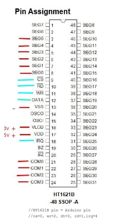

If it helps, these are the 5 wire links in the image:
//HT1621B pin = Arduino pin
//cs=0, wr=2, dt=3, rd=1,irq=4
The red links in the image, were the easy wiring I made the first thing after I soldered the IC.
The harder links are the cyan ones that needs programming data.

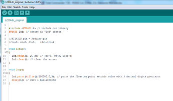

This is the test program that worked perfectly with what I have here.
LCDA3c_original.ino
(420 Bytes)
This program is counting from 0-999 on that little multiplexed 3 digit LCD and restart, so counting to infinite. Its a test program.
This program is assuring (us) me that I connected everything correctly, because it is working.
The next step is to find a way to bitbang those 3 pins.

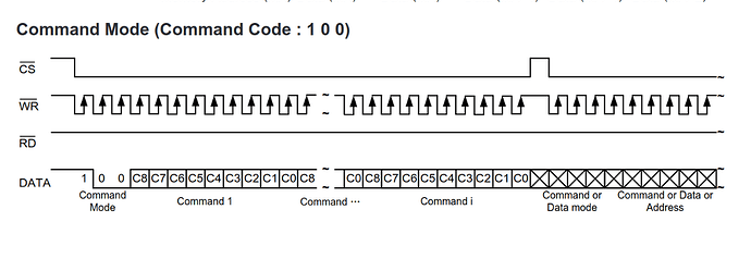

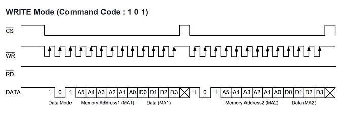

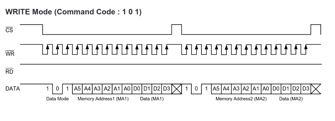

For writing data to the display you follow this timing diagram:
For commands this looks like this:
As code it might look like this:

    void sendCommand(uint16_t cmd){
      digitalWrite(_pin_cs, LOW);
      shiftOutBits(3, 0b100);
      shiftOutBits(9, cmd);
      digitalWrite(_pin_cs, HIGH);
    void sendData4(uint8_t address, uint8_t value){
      shiftOutBits(3, 0b101);
      shiftOutBits(6, address);
      shiftOutBits(4, value);

Thank you @Rintin !
I manage to put something together after your suggestion.
Here is the full code I used:

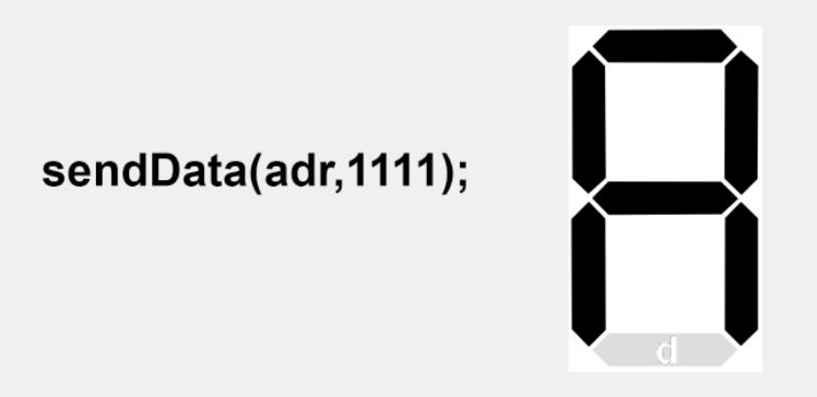

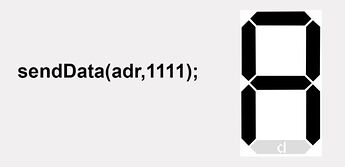

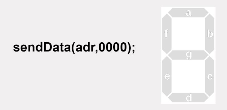

The Clear() is clearing the LCD successfully.
But...
Execute() (afterClear() ) is not changing any segment, and I comment it out.
So I got back to Clear() and modify
its data bits at this line: sendData(adr,0000);
so I changed those 4 bits and I obtained this effect for all 3LCD digits in the same time. This is ok, since Im not aware yet, which range of addr is for digit 1,2 and 3 of my LCD.
sendData(adr,0111); does nothing, no effect.
Im still very confused how this works.
But it is giving signs of working, which is a very good thing; thanks to @Rintin.

Pin 0 and pin 1 on an Arduino Uno R3 are shared with the USB port. Maybe change this pin.
should I put 10k pullup res on these 2 pins? Right now they are direct wired.
probably like this:

The pin is configured as push-pull output. A pullup resistor would only define the level before setup() is called. I don't see the need here.
How would you normally do this?
I change them as
//dt=2, wr=3,rd=4, cs=5,    ,irq=6
  int _pin_data=2;
  int _pin_wr=3;
  int _pin_cs=5;

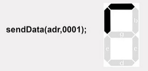

It was a good idea to put back the test program to check the wiring and the code.
Now is checked and working with this new wiring.
like I showed you, in any other type than binary.
this is what I already started to make
I made this test code:

    for (int i=0; i<64; i++)
    sendData(adr[i],0001); delay(100);
I avoid to add that Clear(), because after it, nothing works.
Clearly I dont know how to clear it properly.
And even if its clearing the LCD, it is clearing something else that is not allowing any other code execution after it.
The code I made here is looping now, and is opening the same segments as before.
You are counting in octal.
000111 (octal, leading zero) = 73 (decimal, no leading zero) = 0x49 (hexadecimal) = 0b1001001 (binary)
0b !!! Im always forgetting it !
Ill remedy it now. thanks.
I like to write number either in decimal or hexadecimal. Except there is an advantage like... the datasheet has an other representation and I'm to lazy to convert.
    void Clear()
      for(uint8_t adr=0b0; adr<0b111111; adr++)
        sendData(adr,0b0000); //clearing the LCD succesfully to 000
with this new clear function, the code after is executing !

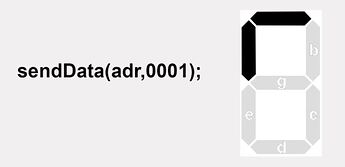

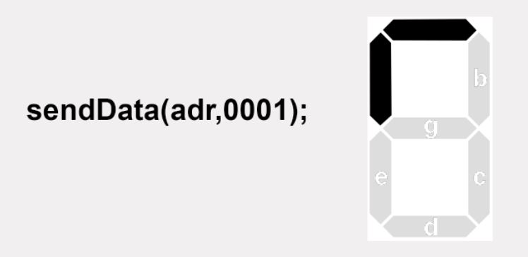

and my new code is actually blinking the LCD but with these segments open:
   config();
   Clear();
    for (int i=0; i<16; i++)
    sendData(adr[i],0b0001); delay(200);

aaaaaa i remember something !!
I believe I understand why is showing me this symbol !!!
I made some very simple tests and I believe that the digit is composed from 2 addreses,
First 4bits of address = half of the digit segments and the next 4bits of address is the other half of the digit segments.
I used this code:
    sendData(adr[0],0b0001); delay(200);
    Clear();delay(100);
where I changed manually the address number in adr[0] as 0, or 1 or 2.
when Im changing it to 2, it is switching to the second digit.
So to be clear,
adr0 and adr1 creates digit1 from the 3digits of the LCD
adr2 and adr3 creates digit2 from the 3digits of the LCD
and finally,
adr4 and adr5 creates digit3 from the 3digits of the LCD
