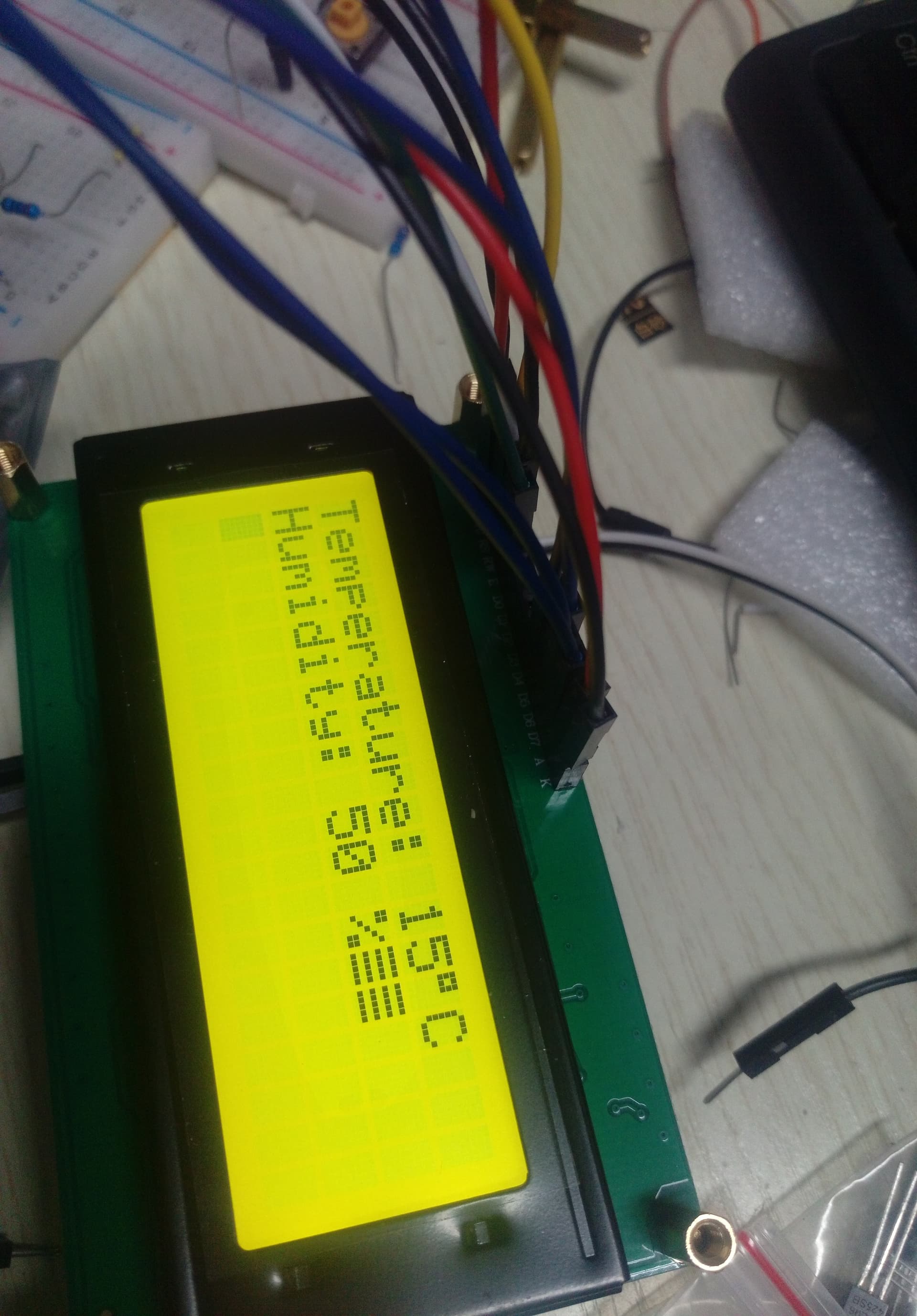

How to erase these 2 symbols on LCD2004A?
I got 2 bit pattern symbols at the end of the second line after lcd.print(" %");, When I run lcd.print(" \n"); after lcd.print(" %"), it wouldn't disappeared, and would attach another 3 this symbols after a space, why and how to remove these?

use print instead of println.
print (" \n") will also print this line - so why do you send \n when you dont need them?
P.S.: it seems to be LCD2004 ... 20 characters, 4 lines. You can correct your thread header.
It is not clear from your description but it seems that you are trying to print a '\n' (newline) character which will not work on an LCD
Instead, use the setCursor() function to position the cursor before printing the data
If you still have a problem then please post your full sketch, using code tags when you do

here is my code:
        lcd.setCursor(0, 0);
        lcd.print("Temperature: ");
        lcd.print(temperature);
        lcd.print("\337C");
        //lcd.print(" °C");
        lcd.setCursor(0, 1);
        lcd.print("Humidity: ");
        lcd.print(humidity);
        lcd.println(" %");
        lcd.setCursor(0, 2);
        lcd.blink();
And the probable solution is in posts #3 and #4. Did you try it?
In order to "remove" them, you need to overwrite them with a SPACE character. You can avoid this by making the temperature and humidity values a fixed width so your degC and % symbols don't need to move. For example if your temperature changed from 10 to 9, then when you display the 9, display a space before it.
Once you have your display text setup, you can then just setCursor to the value position and overwrite it rather than displaying the associated text as well.
 lcd.println(" %");
Don't use println() as the LCD cannot interpret the Carriage Return and/or Linefeed that it outputs. Use print() instead and position the cursor using setCursor()
