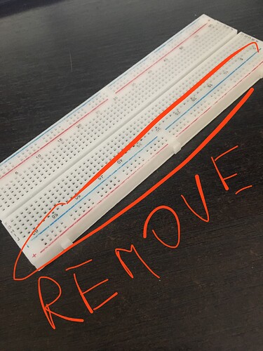

Problem: The standard breadboard is a bit narrow for the standard ESP32
Luckily these breadboards are assembled from 3 strips and can be mixed and matched
Remove power rail on one of the breadboards and connect it with another one
PROFIT!
