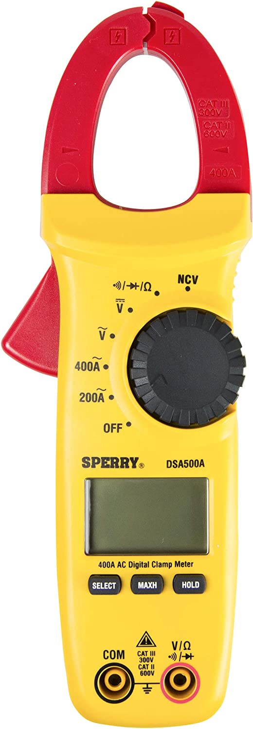

I'm pretty sure it is auto ranging, as I also use the meter to test heating elements in hot water heaters and they read 35
I think it reads it I thousands though, so that might be 2.2 thousand ohms.
This is the meter
Your DMM is an electricians DMM, any resistance over 4000ohms will be requarded as open circuit.
Tom.... :slight_smile:
Well, I am an electrician....
So, there is no way of figuring this out without buying a more accurate meter?

Get a MANUAL meter. Not a bloody annoying autoranging one.
Leo..
It's not totally necesssary to get a manual meter. Autoranging does work for simple measurements like this. It will be worth your time to read the manual and work out how to get it out of auto mode.
Cheap pocket-size meters can be had for $12 or so. That's what I use most of the time, even though I keep mine on top of an 'accurate' meter which is too heavy to be lifted off the bench.
