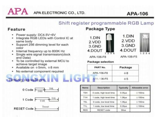

either a SX1509, there are even some SX1509 backpacks available, or you consider some kind of Neopixels. These are available as APA106 in a common 5mm LED form also. OK, they are RGB, but very easy to control and very easy to wire
noiasca:
Oh, didn't know there were individual neopixels like that. Thanks for your help!!!

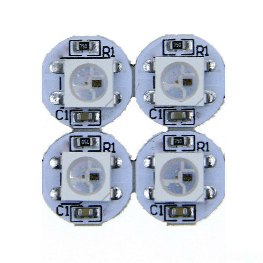

You can have them either pre-mounted on PCB chips with the 0.1 ยตF capacitor and series protective resistor

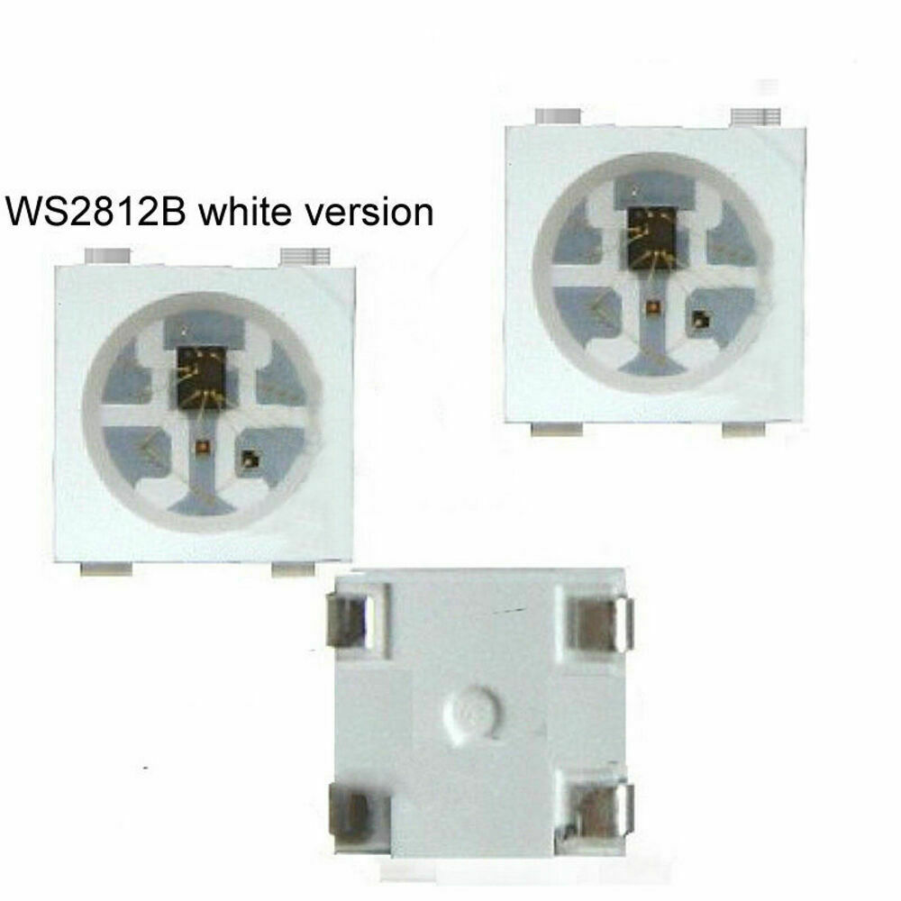

or bare chips:
or 5 mm LEDs:
