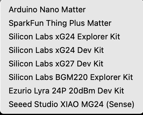

What makes you think that would work?
I have a XIAO MG24 and it works there but I would not expect it to do anything on a Pi or Arduino. Here is a list of boards supported by the Arduino boards setup.
