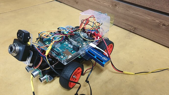

For simplicity, I just want the motor to run fully on or fully off, attaching enA,enB only to pca9685 pwm pins or attaching all the 6 pins to pca9685 pwm pins

Maybe I only have a little amount of idea on how this L298n works, but I have attached all the 6 pins of L298n to pca pwm pins, and control the dc gear with its speed and rotate direction using python as I am connecting it to raspberry pi, I can control it with ease.
Now I want to avoid connecting again the 1,2,3,4 pins to arduino, all because I'm using Arduino Due, If the 4 pins not be connected in pca9685 then I will just use level shifter as the signal output of L298n is 5v and Arduino Due operates at 3.3v
I already have 3 servos attached on pca9685 and planning to use unused pwm pins on it with all 6 pins from l298n to avoid using the level shifter to my arduino Due. If I cant find any solution for this, I think I have no choice but add another hardware (level shifter)

Thanks, I'm confident that I can modify a code the way I like, I'm ordering an 8 channel biderectional level shifter to handle the 6 pins from L298n to arduino Due IO pins, By the way whole project is using raspberrypi 4 with INTEL NEURAL COMPUTE STICK for ARTIFICIAL INTELLIGENCE only , sending data to arduino DUE serial, A mega 2560 that is busy on processing 3 ultrasonic sensor and 1 tf-luna lidar sensor to be send in arduino DUE serial1
