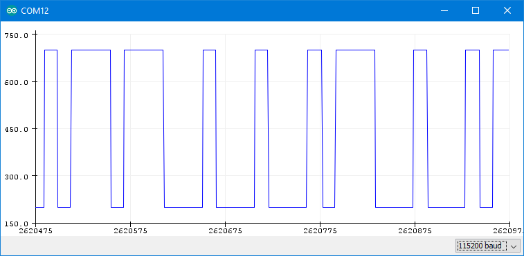

I have a 5Ah EGO battery and have been trying to interpret the binary pulses from the data pin on the battery (I have attached a picture of the battery contacts).
When you buy a tool pack (blower, line trimmer etc.) they give you a slow charger and a battery (normally 2.5Ah), I have 3 slow chargers now so one was harvested for the 4 pin connector which is just held in with a plastic bracket and screws.
All the tools have the data pin but not the temperature pin. When the battery is on a running tool the LED on the pack lights up green or red depending on the battery voltage, without the data line connected (like on my electric bike) the LED stays off but you can still draw power no problem.
The battery has an internal 10k pull down on the data line, so I connected ground and data to my Teensy LC board with a 4.7k pull-up to 3V and the LED lit up, after some messing around I created a sketch that reads the data pin and outputs a 700 (High) or 200 (Low) to the serial port so I could see the pulses in the plotter: (See attached plotter images)

I'm not exactly sure how the bits are represented here as long and short pulses are both high or low in all combinations.
The LOW start pulse is around 1200us
Long pulses (high or low) are around 600us
Short pulses (high or low) are around 200us
Space between bursts can be 10000us up to 120000us long!

This isn't 1wire, I thought it might be some form of Serial but my attempts ended with garbage every time.
I tried reading up on binary data sending etc but without knowing the magic words I ended up in circles.
If I can get the 1s and 0s worked out I would be able to write some code to translate it into something meaningful (like battery voltage I hope!).
Any help translating would be greatly appreciated.
