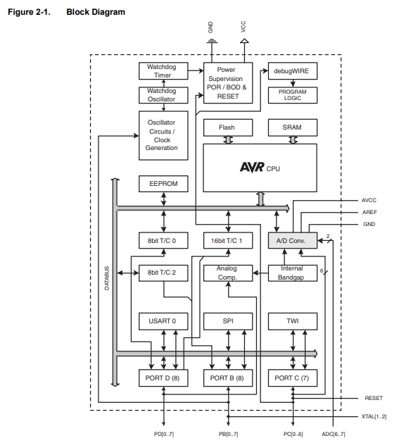

This kind of level:
(that's from the ATmega328P datasheet)

You could start with a good old UNO. Pick one of the hardware modules such as the UART and read up on how it works from the 328P datasheet.
Try programming the UART registers directly so you learn about baud rate generation.
Most micros have 1 or more UARTs and they all operate in a similar way.
Once you understand UARTs, then maybe move on to the SPI interface, and learn about that. Program the registers directly. Get yourself something simple to interact with - maybe an SPI EEPROM.
You can have a play with timers and then introduce timer interrupts to get a feel of the interrupt system.
Timers can be counters, so maybe play with that feature.
I2C is a bit more involved, but the official I2C spec will guide you.

Block Diagram for the Internal Resources of ATmega328P Microcontroller:
