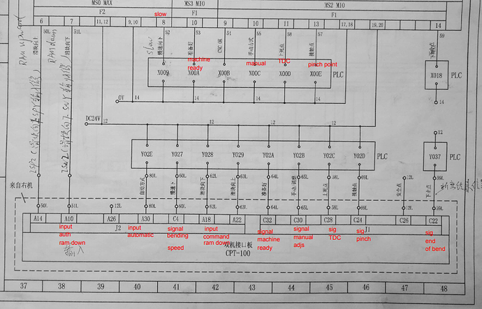

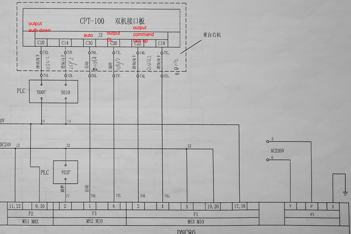

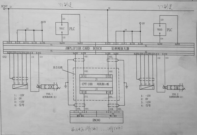

below is the CYBELEC DNC 80 input and output controller : ( I also included the schematic drawing in the attachment , datasheet TANDEM, datasheet board servo hidrolis ) :
MSO MAX is the output of the Cybelec controller, 50L cable number is the SPY ram up authorization output, and 51L is the SPY ram down authorization output.

WestJava:
if the masters could make the code for Arduino in lieu of this Cybelec model press brake controller. I am sure, Arduino boards will become mandatory for all industries. and industrial technicians.
I don't understand the relevance of that.
Who are the "masters" ?
Arduinos are boards for hobbyists and maybe for prototyping industrial products.
...R
I'm sorry, I just want to attach my schema and datasheet to my hardware. so that it can be understood. because it won't fit, I repeat it. Forgive me. thank you for your advice. I will follow what you say.

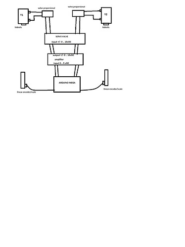

can you give me a sample code to synchronize these two hydraulics and linear encoder as a counter. Y1 is the right hydraulic, and Y2 is the left hydraulic.
if input servo selenoid valve is -5 volt DC , hydraulic go down. and if input servo selenoid +5 volt , hydraulic go up.

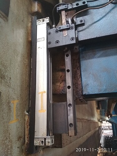

My machine has 2 linear encoders.
And the My old controller has 2 Voltage outputs (axes Y1 and axes Y2) = ± 10 VDC output impedance Zout = 100 Ω
Load Zi ≥10 kΩ
(velocity).
and 2 Analog voltage outputs (pressure, crowning) = 0-10 VDC output impedance
Zout = 100 Ω
Load Zi ≥ 10 kΩ

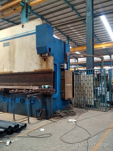

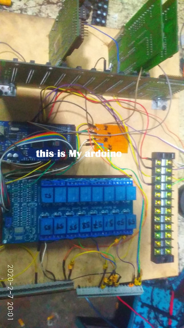

You wrote a while back:"the way this machine works is if I press the pedal down, then the Y1 axis and the Y2 axis go down fast then it becomes slow, so the operator can place the workpiece on demand. after that continue to bend according to the desired degree. after finishing bending Axis Y1 and Axis Y2 rise quickly (back to home).".
Does this mean your machine has 2 hydraulic cylinders, each powered by separate hydraulic pumps and controllers? The Utube video did not show any hydraulic cylinders. Can you take a picture of your machine and post it?
Paul
Very true, Mr. Paul. My machine has 2 hydraulic cylinders. Each is powered by a separate hydraulic pump and controller.
I have uploaded a picture of My Machine. you can see it.

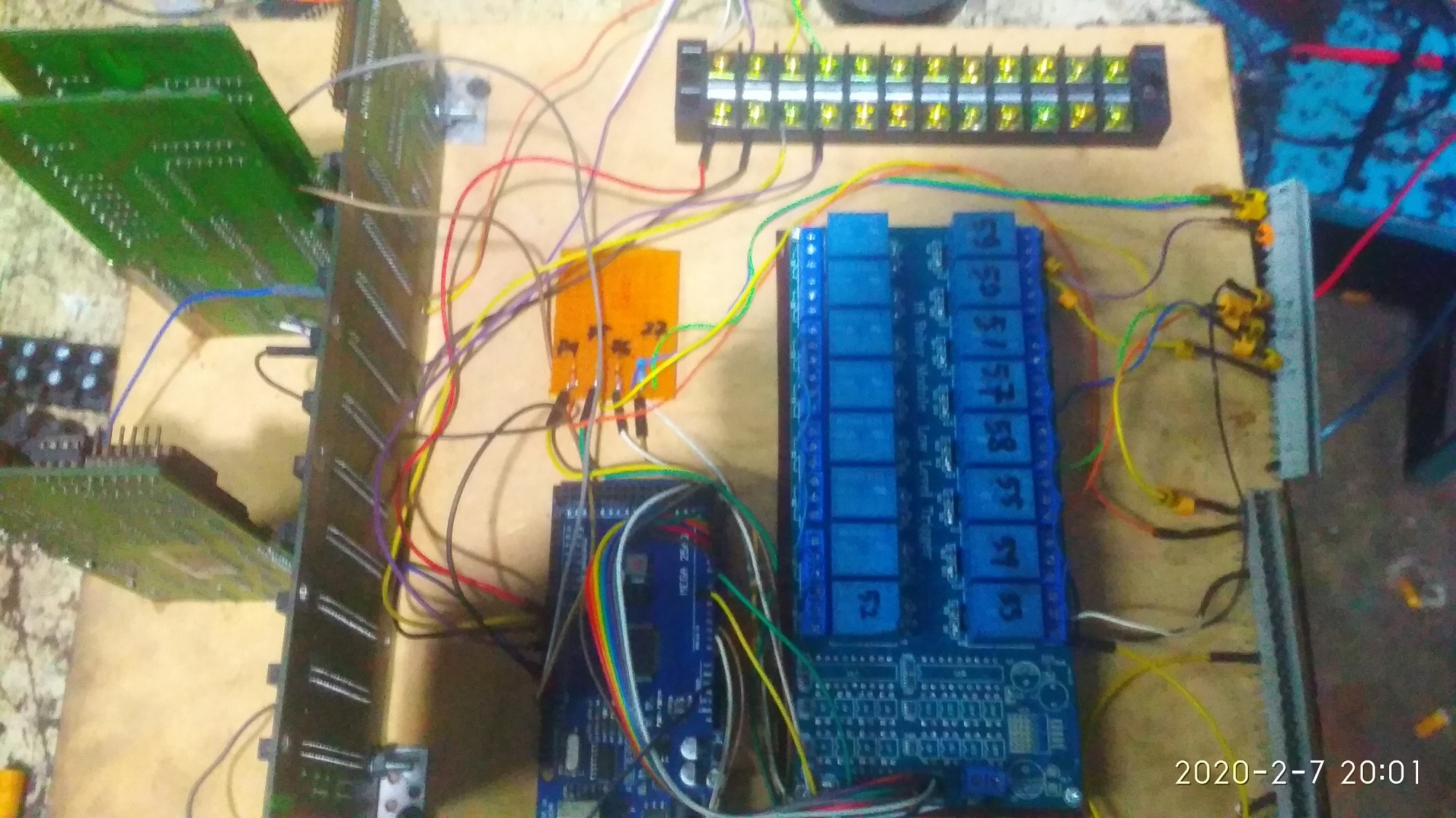

and this is my arduino ..
Please display your image(s) in your post so we can see it(them) without downloading it(them). See this Simple Image Posting Guide

this my machine

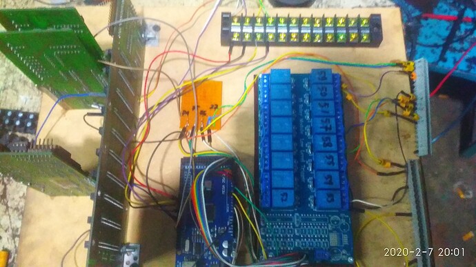

and this is my arduino mega
Please go back to your earlier posts and make all your other images visible also.
