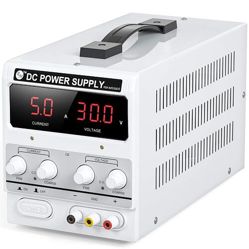

Thanks for the replying. My system is as setup in the image at 1st post, and I am using the 2nd circuit. The external power is some DC Supply similar to this one :-

Should I increase the ext.power current limit to 2A ?
Should I set its voltage to a bit higher, like 6V?
1 amp per servo is what I do.
