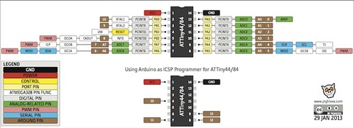

How to make the circuit for programming ATTINY44A ?
-I received 10pcs of SOT14 ATTINY44A
This is the second microC that Im working with from Atmega (the first one was TQFP32 ATmega328P).
-And I want to program it. And being the first time for me, I need some guidance. What circuit to use? probably some ICSP wiring? and what library to download ?
In my mind this older uC should still be programmed with Arduino Uno R3 that I have.
Thank you !
There's no library afaik but in Board manager you can get TinyCore.
You can use your Uno as a programmer. Wire it just as you would wire the 328P (SPI, not exact pin numbers).

Do you have a circuit diagram for programming wiring of my ATtiny44?
It's been a while since I used IDE v1, but it looks like you're using v1, meaning you have to download the TinyCore and install yourself, just like you did with MiniCore.
This is the link GitHub - SpenceKonde/ATTinyCore: Arduino core for ATtiny 1634, 828, x313, x4, x41, x5, x61, x7 and x8

Same wiring as attiny84, if you can find that.

I find this img, (on this forum)
I also find this page: ATtiny84 8-bit AVR Microcontroller Pinout, Features, Specs & Datasheet
.+ a circuit diagram:
Using arduino Uno is more simpler I guess... Im probably wandering at this point.
Again, my very first time dealing with these NEW chips !
Uno got a 6 pin header that you will find corresponds to digital pins 10-13, +5 V and GND. If you programmed 328P with the Uno you should be familiar with the ICSP hookup.

I don't think ATtiny44/84 supports that, only ISP programming (also called ICSP programming). You can use Uno as a programmer for that by running the ArduinoISP sketch.
Where did you see that? I think it may be possible using Digistump bootloader.
But with only 4K of flash memory, any bootloader is going to take a significant % of flash, leaving you with less for your sketch. Maybe stick to using ISP!
When I programmed 328P, I used only the ICSP port, not the arduino pins. So I was unaware of it's corresponding arduino pin number.
Thanks to you, now I updated my reference pins image with that ICSP port down in the image.
The Reset pin was actually not used in 328P ICSP programming PORT/pins.
I had to link a wire to pin 10. Should I update my image with this little detail as well? as being a general rule? or it was only specific to 328P but not to the other chips?
Thanks !
Right, pin 10 to ATtiny44 reset pin. :+1:
