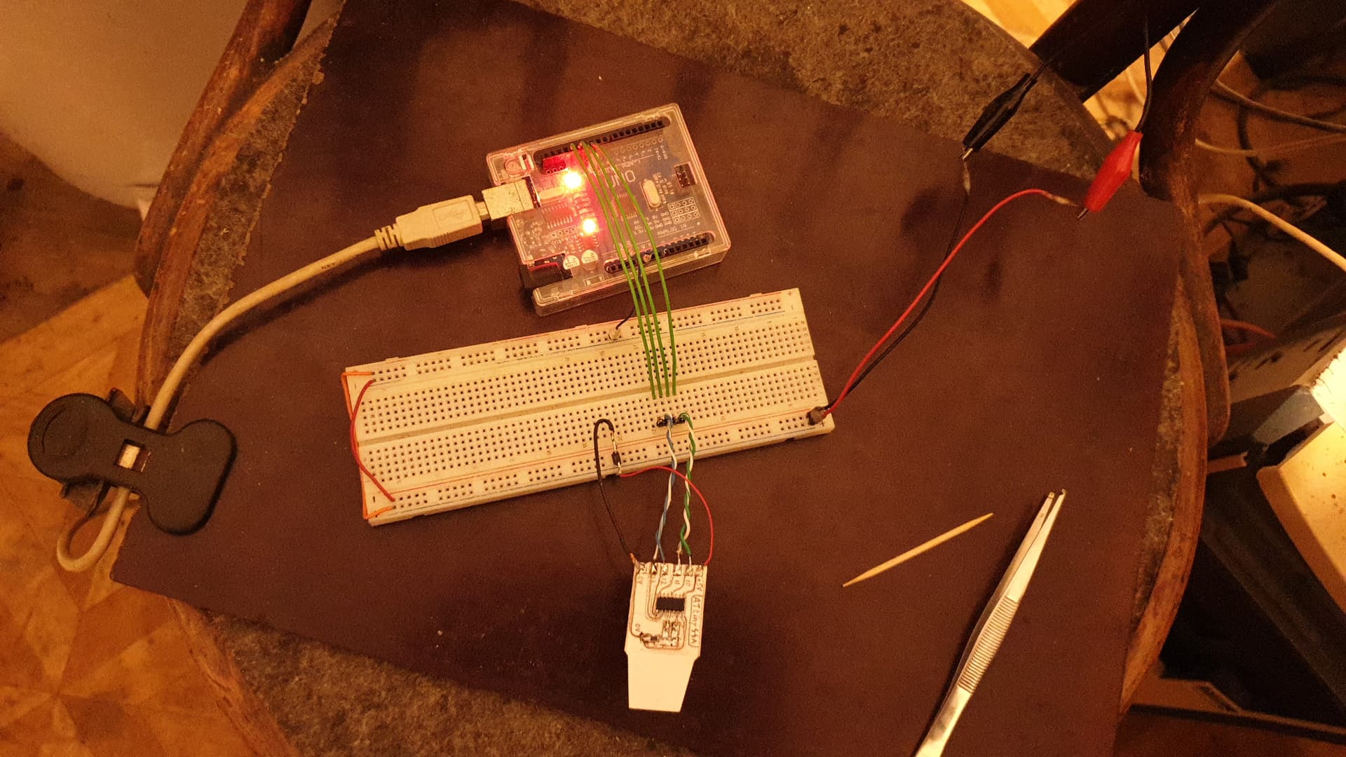

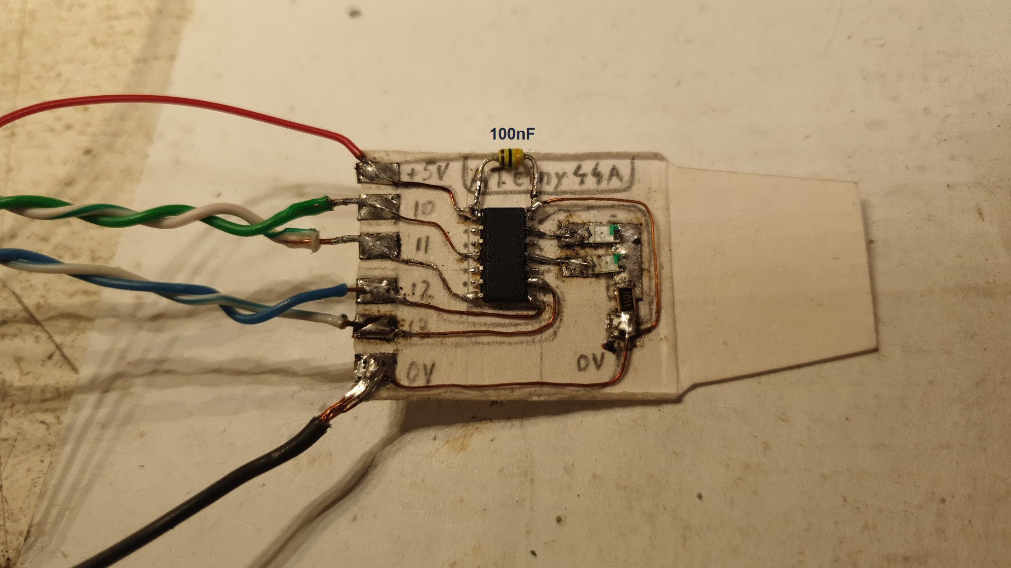

OK, I finished the board !
and linked it to my Arduino Uno R3

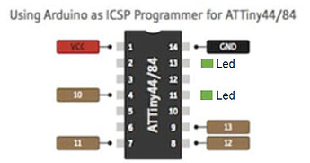

using these pins as in this reference:
I'm powering my cct with an external 5V from a small PSU.
I have a common negative wire between Arduino Uno and my cct.
Next step is to actually program it !

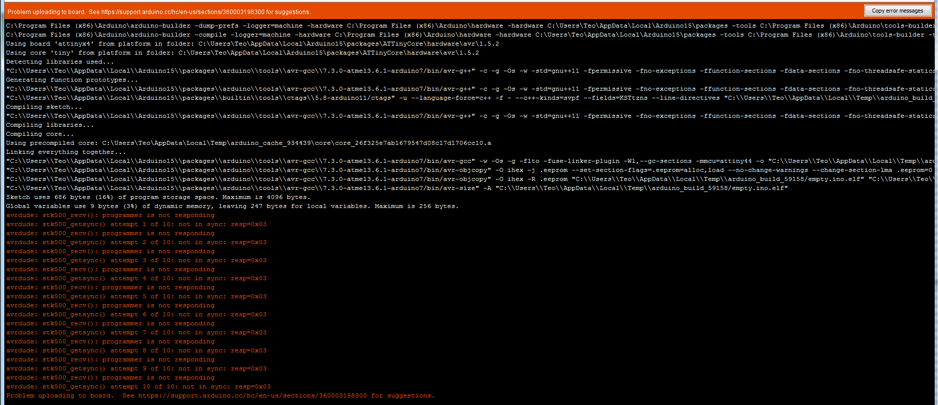

I get an error for both [upload] the program and for [burn bootloader] options.

Did you install a capacitor for the Uno? Do you have a 0.1 / 1 uF ceramic cap between Vcc and GND on the ATtiny?
I wouldn't bother with a bootloader since this chip is short of mem.
I've added now a 100nF on the power rails, on the bredboard.

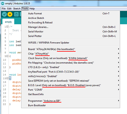

Here are my 'new' settings
While uploading, is also freezing for 1min or so. This is a sign that is trying to connect like the error says. Usually, I can see led13 on Arduino UNO blinking when programming something because it is linked to TX pin. But NOT NOW !
Added 100nF directly on the power pins.
I also rechecked the other connections, they are cemented and good.

  • The only error is about bootloader for ATtiny44 when trying to upload Arduino as ISP
  • and the connection "not in sync" when uploading my test sketch.

Very small change. Before I was powering with external 5V.
Now Im powering exclusively from Arduino board, the 5V and 0V rails.

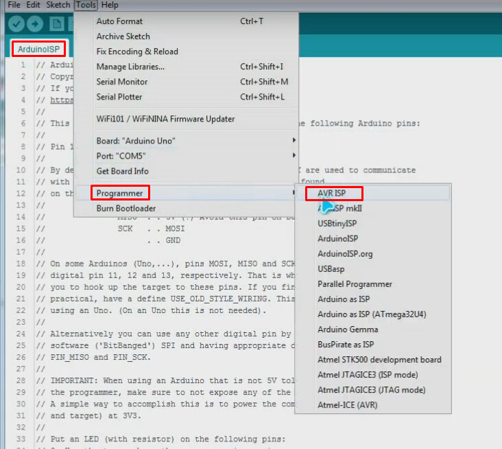

Well you can keep trying the Arduino as ISP sketch as long as you want... it will never work.
What do you intend to do with these ATtinys?
The only programmer you got at hands there are the Uno when it's running the AaISP sketch. The ATtiny85 I uses as a programmer have a firmware loaded, making it into an USBtinyISP. But there are no sketches (maybe somewhere you can download them?) that turns an ATtiny into a programmer.
In order to use your ATtinys you need to first choose one in the Tools menu, pick the appropriate settings and then Burn bootloader, even if you don't intend to use one (and I recommend you to not). After this you can start New sketch or load sketches, and to upload you cannot just pick Upload, but Upload using Programmer.
I found the problem !
This is how you upload correctly that ArduinoISP sketch !
Now I get no errors and it is programmed !
I believe I left that ATtinyCore activated when trying to program ArduinoISP !!! <<this was the mistake !
