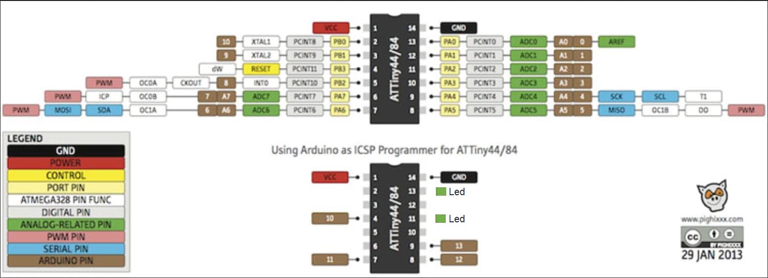

How to make the circuit for programming ATTINY44A ?

I also successfully upload my test program with 0 errors, using all the ATtinyCORE fuse settings ! Which is great !
But the program itself is not working, those 2 leds are not blinking.
Is there something else Im not aware of?
Post the sketch.
YES !!!!! I made IT !!!!
It is working NOW !!!!
Ohooa !!! Thank you mister @ledsyn !!!!
The pins declaration was wrong, because I used the chip pin numbers. Rookie mistake, I know. Haha.
So I quickly realized that those are digital pins I need to insert in my code. The Gray marked ones.

I had a sneaky suspicion :slight_smile:
And you're given the choice of two different pin numberings, when about to burn the (bootloader) fuses.
