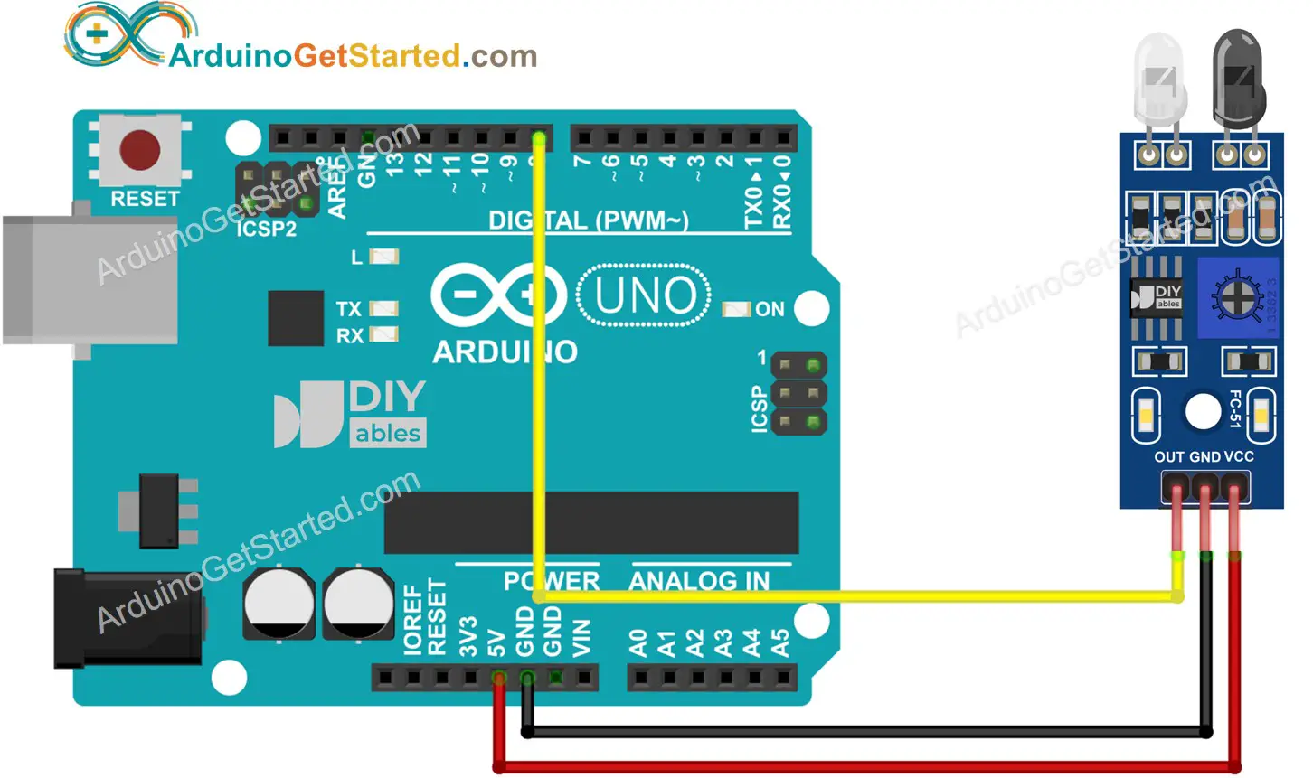

Your sensors appear to be this type
They have input voltage 3.3 to 5V, so you can run the whole circuit off 3.3V and no logic level shifter or voltage dividers will be needed.
In the linked tutorial from that page, it suggests that they have a digital output:
So not even any ADCs required!
