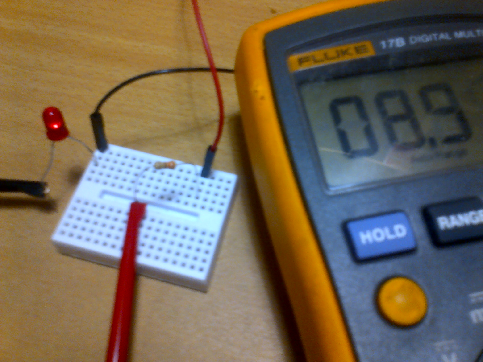

hi, I tried to measure current rate in ordinary blink program's led circuit in arduino, so that I interrupted the circuit in between Led's Ground pin and resistor from digital pin 7 (which I set as Output pin) I connected my multi meter in series in the circuit ( positive of multi meter to led negative and ground of the multi meter to resitor through ground of arduino) but circuit is not working and also it is not showing any current rating, I have dialed- my multi meter in Amps mode even in micro amps mode it is not working.
Are you sure the LED's the right way round?
What you're doing is basically what I did a while back as shown in the attached photo.
Just looked at the image. Apparently it shows 30ma. That's OK and even a tad higher than average LED actually needs.

Yeah!!!!!!!!!!!!!!!! Thank you guys. Fuse only gone. Now it is working.
Excellent.
So now you need to ask yourself, what you did to pop the fuse last time you used the meter.....
yes, before somedays I measured Higher current more than fuse rating. Thank for helped me.
