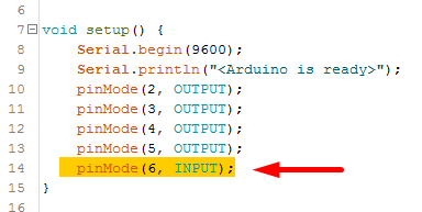

I made pin6 as an input, as I said, then I inserted this code specifically for input:

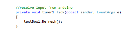

And from my C# program, nothing is updated, but when Im pressing any Button to insert data into textbox, immediately I can see some random 0 or 1, from my input !!
I think I have to Update() or Refresh() my textbox? in a timer? Hmmmm....

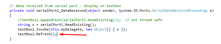

next, in C#, Ive added that line in the serialPort1_DataReceived event.
But.... I got an error:
"Cross-thread operation not valid: Control 'textBox1' accessed from a thread other than the thread it was created on."

Ill try with a timer, hopefully it will not interfere with the other thread?
And it didnt interfere with the other thread but it didnt helped either. Nothing is displayed. I believe we have to go into the hole of threads now? Huuuuuuhhh.
this where Delegates are use to pass information between threads, i.e. the serialport event handler and the textbox1 are running on different threads
the call
textBox1.Invoke(this.myDelegate, new Object[] { s });
passes the string s to the delegate
AddDataMethod(String myString)
which will update textBox1 so there is no need for you do a testBox1.refresh() - if you do need it put it in the delegate

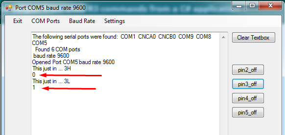

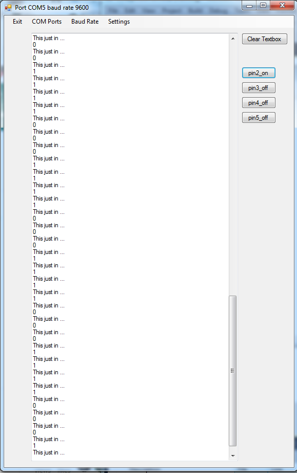

and Im getting this result here:
You can click on the image with your mouse and it will pop out in a bigger resolution, actually the resolution it was uploaded, and it will be very easy to read the details inside it. You can always right-click on the image and choose Save-as on your PC. You can then open it with your favorite image viewer and zoom into it way more than you can in a browser. You only have to get used to it, thats all. I am very used to work with images so its easy and intuitive for me to do so. I told you my pov about this matter. Images are a very useful tool to convey an idea which would take too many explanations in written form.

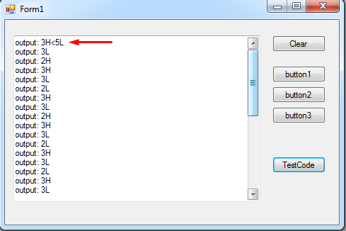

Ok so Im getting that "This just in ..." every time Im receiving an input of 0 or 1.

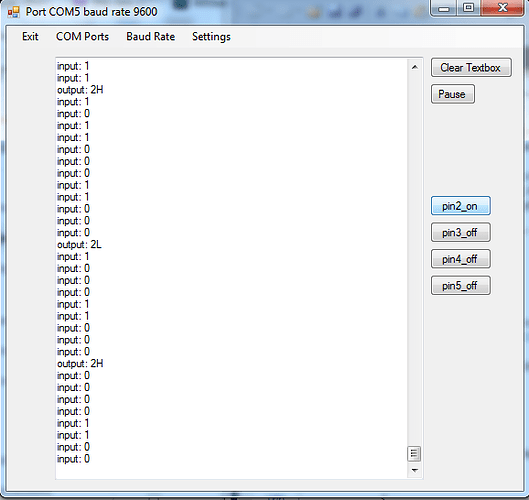

I modified my arduino program to write "input" and "output":
This is how is looking so far:
But I can not implement a --Pause-- button in there.
Can you help? This code is running continuously. A pause/play would be very nice.

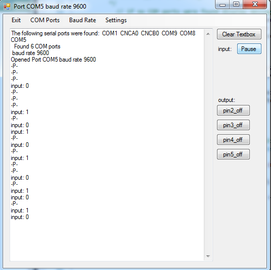

Please click on the image to enlarge it and to see better the text in it !
That -P- means when I press the Pause/Play button and how many times it counted and then stopped.
Sometimes no input, sometimes 1 and 0 and then stop, and it spit it at once.
-I want a 1 when input is High and a 0 when input is Low, at the speed it is actually running. Very slow for the moment.

when experimenting I have written serial data received by the event handler direct to a TextBox, e.g.
// data received from serial port
private: System::Void serialPort1_DataReceived(System::Object^  sender, System::IO::Ports::SerialDataReceivedEventArgs^  e) {
	textBox1->AppendText(serialPort1->ReadExisting());
generally works if run without debug - with debug it will crash with thread accessing error
I don't recommend it for end user code though
