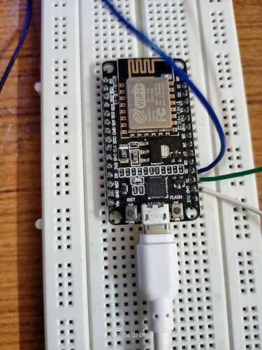

hiii, I am getting serial data on my node mcu from the DC energy meter in the below form.
C1.8D1V0.0DWh0.0DAh0.0D

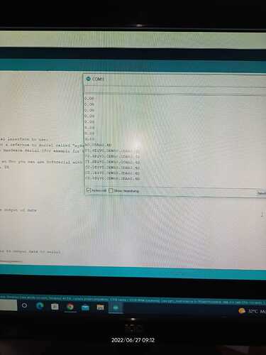

I am able to parse data when and only if i type on the serial monitor and click on the send, then i get the floating values, as you can see i am getting serial data from the DC energy meter but it is not parsing.

this is what i am getting on my serial monitor.
1
2
that 1 is for overcurrent detection.

I dont find any carriage return. all i know is at the end of every value there is "D".
Please post the sketch that you are using to read the data
this will read such a message from Serial and print the values every 3 seconds to serial

Thanks for the help, But how i suppose to parse the data which is coming from the serial port, the data which i can see on the serial monitor. please guide.
I am using your code but data which I am receving from the DC energy meter is not parsing into float value, only values which i manually inserting on serial monitor through send tab. Your code is very good but failed to fetch serial data n converting it into float values. please guide!
circuit diagram
So you don't I'm assuming?
Guess you need to figure out how to read Serial data.
https://www.google.com/search?q=arduino+reading+serial+input
