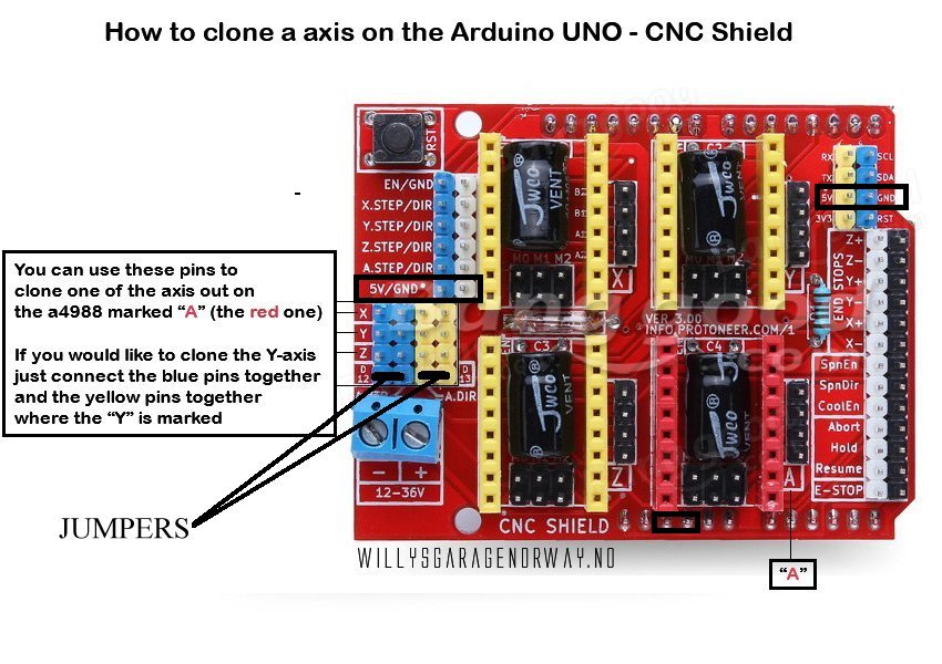

Think twice about powering the Arduino through the Vin or the power jack. Powering through Vin or the power jack means that the Arduino and all peripherals that are on the 5V rail are powered by the onboard 5V regulator. The on board 5V regulator is not heat sinked so will supply limited current before it overheats and shuts down. The recommend max power dissipation for the regulator is 1 Watt. With 12V into the regulator the max current is about 140 mA (1W / (12V - 5V)). The Arduino uses around 50ma of that leaving less than 90mA (max) for everything else.
I would use a buck converter to drop the 12V to 5V and connect that to the 5V on the Arduino, bypassing the, weak, 5V regulator.

After finishing my test results, I will try to make a first fully functioning prototype with 1 power supply by connecting the motor shield to the adapter. A DC-DC step down convertor, 12V to 5V, will be needed as well, to power the arduino from the motor shield and connect that to the arduino uno.
Yes that is correct. Connect the output of the 12V to 5V DC DC converter to the 5V pin of the Arduino, not the power jack or Vin. There are a couple of places on the CNC shield to connect 5V and ground from the DC DC converter. Look in the black boxes.

With the CNC shield in place there is no 5V or ground accessable on the Uno itself. Connecting to the 5V and grounds on the CNC shield (black boxes) will supply power to the Uno.
Do not power the Uno through the 5V pin (external 5V supply) and USB at the same time.
